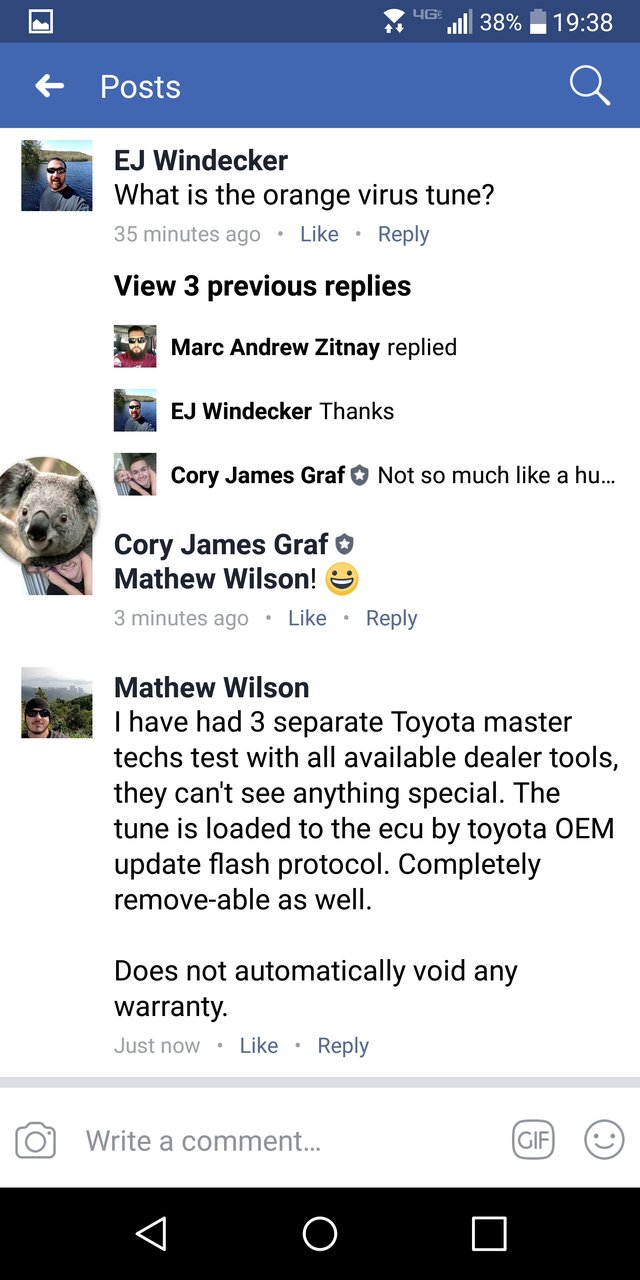

    1. Correct, 87 and 91 tunes available and you get both with the price of admission (plus updates are free). Is it worth it to run 91- it is to me, but it may not be to you. I've run both, and on my truck the 91 tune is definitely more responsive/powerful.
    2. I've been there a couple of times but not for anything that involves the stealership messing with the ECU. I did not flash back to stock, but could have in 5 minutes. Others on here have as well, and can add their I/P. Mat claims they can't tell with their scan tools that we are running a tune.
    3. Yep, you'll get the USB dongle (security) and OBD cable/interface with the kit.
    4. Mat has sales on the go periodically, maybe there will be one for St. Paddy's day - who knows lol
    HA, don't know. Let's see TROLLOLLTROLLLOLLLTROLLLORLLLTROLLL

    I'll let you know more on number 2 tomorrow. I have access to a techstream and going to do a little test.

    Mat has said that he's said multiple techs try to detect it and that they can't. Furthermore, the tune is flashed with toyota flash protocol he's said.
