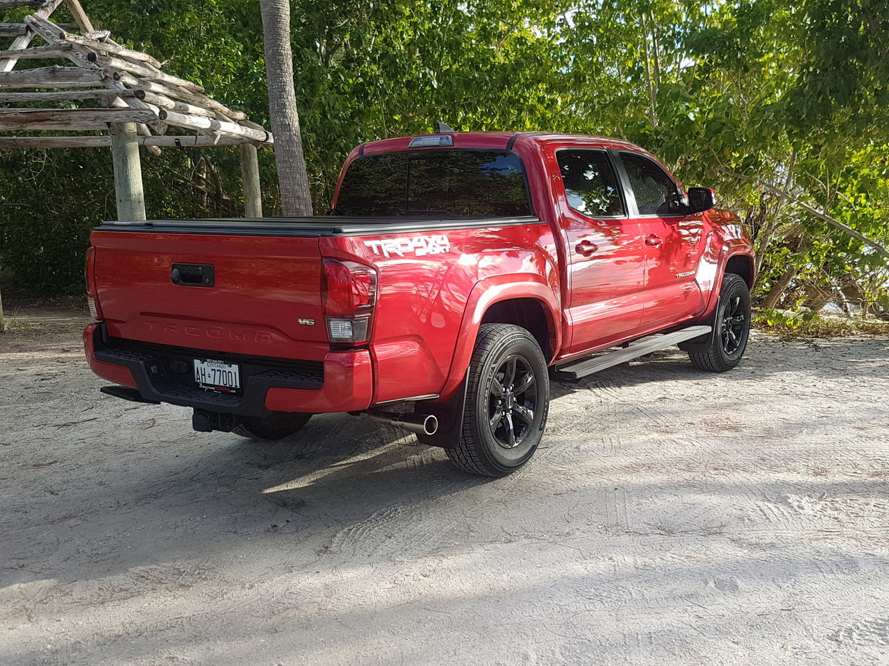

    I can't remember the manufacturer. Stock 17" size with a stock wheel offset. Best pic I have right now.

    Don't let the pic fool you. I do live in a cold part of the country. I had the truck down to Florida for a month during Christmas the day after I bought it.
