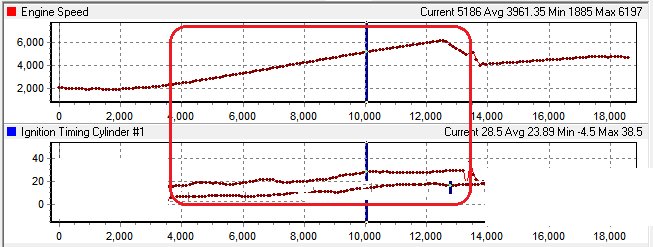

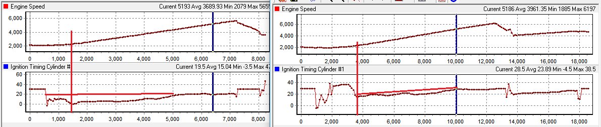

  17. Mar 18, 2018 at 9:45 PM
    #3657
    OVTune
    OVTune [OP] Well-Known Member
    Mar 27, 2017
    #214557
    8,112
    OVTune
    87 octane tune vs 91 octane - some highlights
    Note- this is based on logs from two different trucks.
    This is data is very useful, and as a result of all of this a new version of MT tune will be available to loggers tomorrow (and eventually, the masses).
    87 vs 91 octane logged -
    conditions : Full throttle pulls
    start RPM 2000-
    RPM 2300
    87 octane - 1 degree ignition advance
    91 octane - 14 degrees ignition advance
    RPM 2800
    87 octane - 5.5 degrees advance
    91 octane - 19 degrees advance
    RPM 3300
    RPM 4000
    87 octane - 10.5 degrees advance
    91 octane - 20.5 degrees advance
    RPM 4500
    87 octane - 19 degrees advance
    91 octane - 22 degrees advance
    RPM 5000
    91 octane - 28 degrees
    peak from 5000 +
    87 octane 19-20* advance
    91 octane 28-30* advance.
    here it is with the advance differences on top of a single run
    mZiggy, MOC221_ and 2016trdtacoma like this.
  18. Mar 18, 2018 at 9:53 PM
    #3658
    M1Awolf
    M1Awolf Well-Known Member
    Jun 16, 2017
    #221701
    2,192
    Rob
    Montana
    2017 TRD Off Road DCSB M/T
    That is one hell of a difference between the two. The 91 looks very linear as rpms increase while the 87 seems kind of flat and unstable.
    ETA Are those results from the 1.03C.0001 test tune you sent out or are those from the original 1.03C files?
