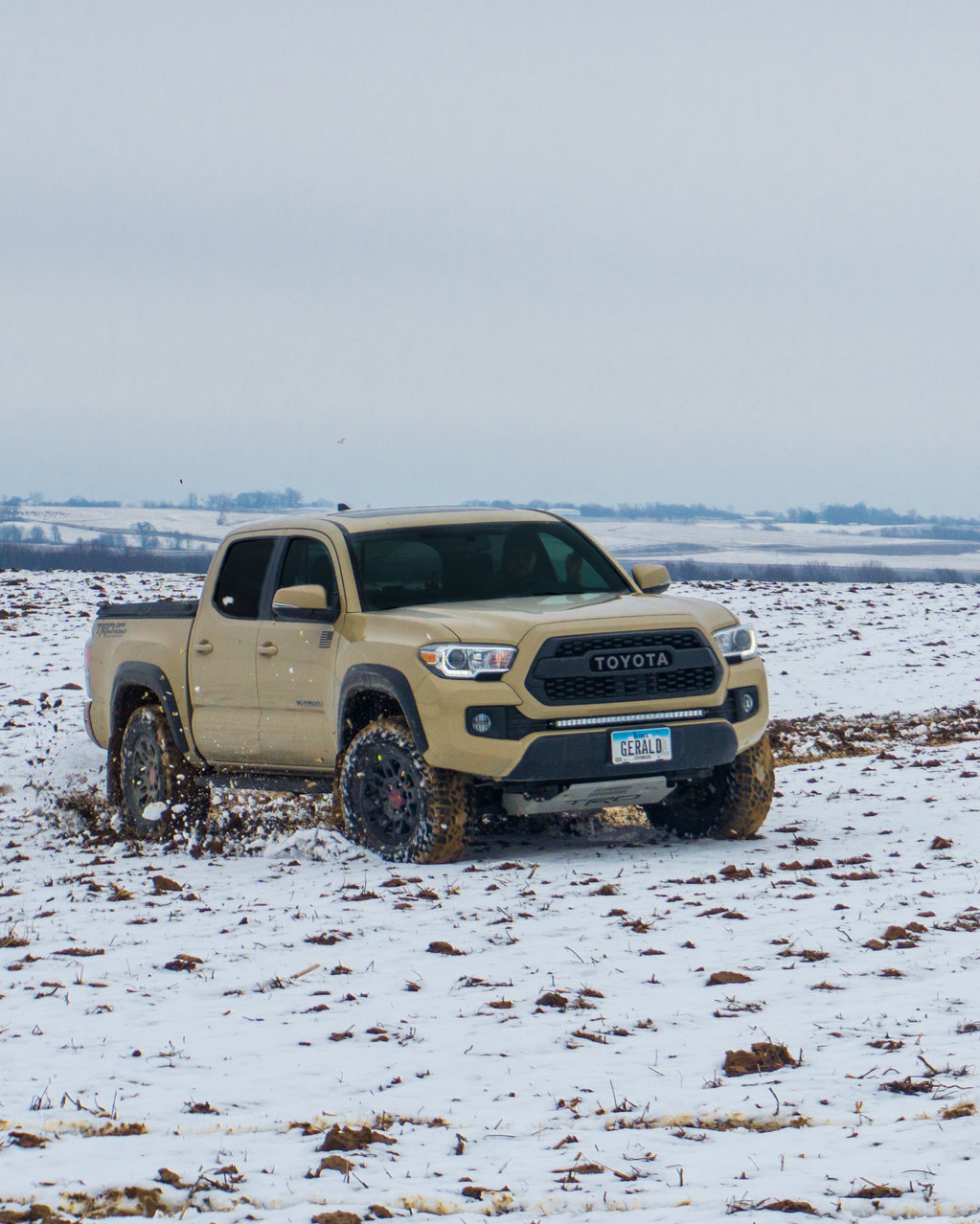

    Shellshock
    Nov 21, 2015
    #170338
    23,480
    Iowa
    Hoping for the updated tune by the weekend :fingerscrossed:
    Still running 1.03B. I’ve got far less complaints about it now that it’s not a complete snow and ice covered mess here. I understand why some people didn’t have any issues with it now that things have dried out. :mudding:
    Had some fun with it over the weekend in some unexpected snow that was gone by afternoon
    2016trdtacoma, mZiggy and MOC221_ like this.

    Fuck I love that color with the black rims/flares/pro grille. All it needs now is a longer box and a shorter cab :D
    JK dude, awesome rig
