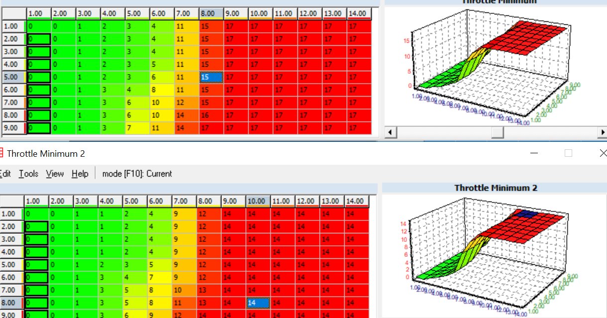

  20. Nov 9, 2017 at 8:27 PM
    #480
    OVTune
    OVTune [OP] Well-Known Member
    Mar 27, 2017
    #214557
    8,112
    OVTune
    Rev Hang throttle minimum on higher rpm?
    Ares32 and Murphinator like this.
