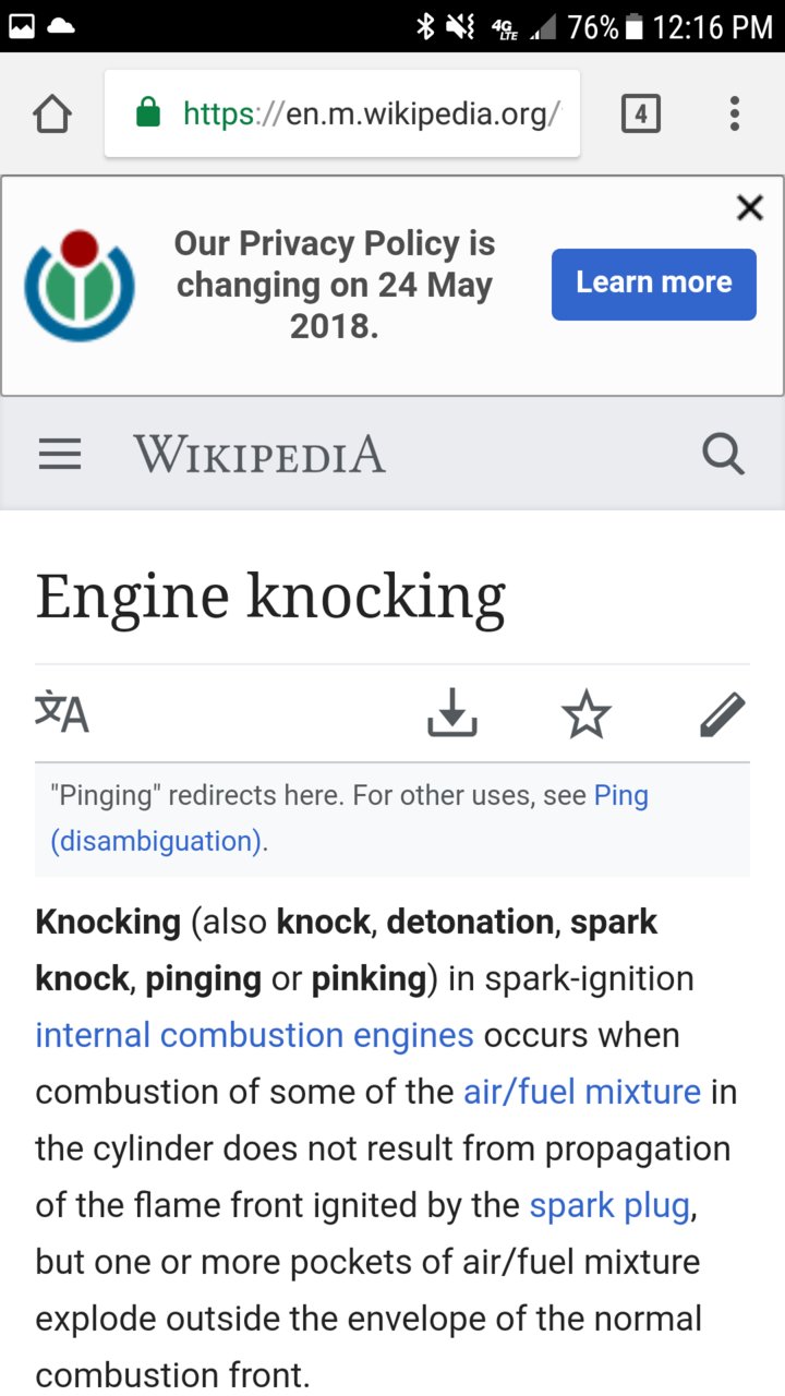

    For posterity so we get our terms right...
    Edit - this same page I posted does list the effect of ping/knock to range from inconsequential to severe, so I stand corrected on that. But I would assume that takes into account how often it occurs and at what RPM and load etc. I'm a marine engine guy foremost with some limited tuning experience on subarus, so I know there are areas that my knowledge is lacking.
