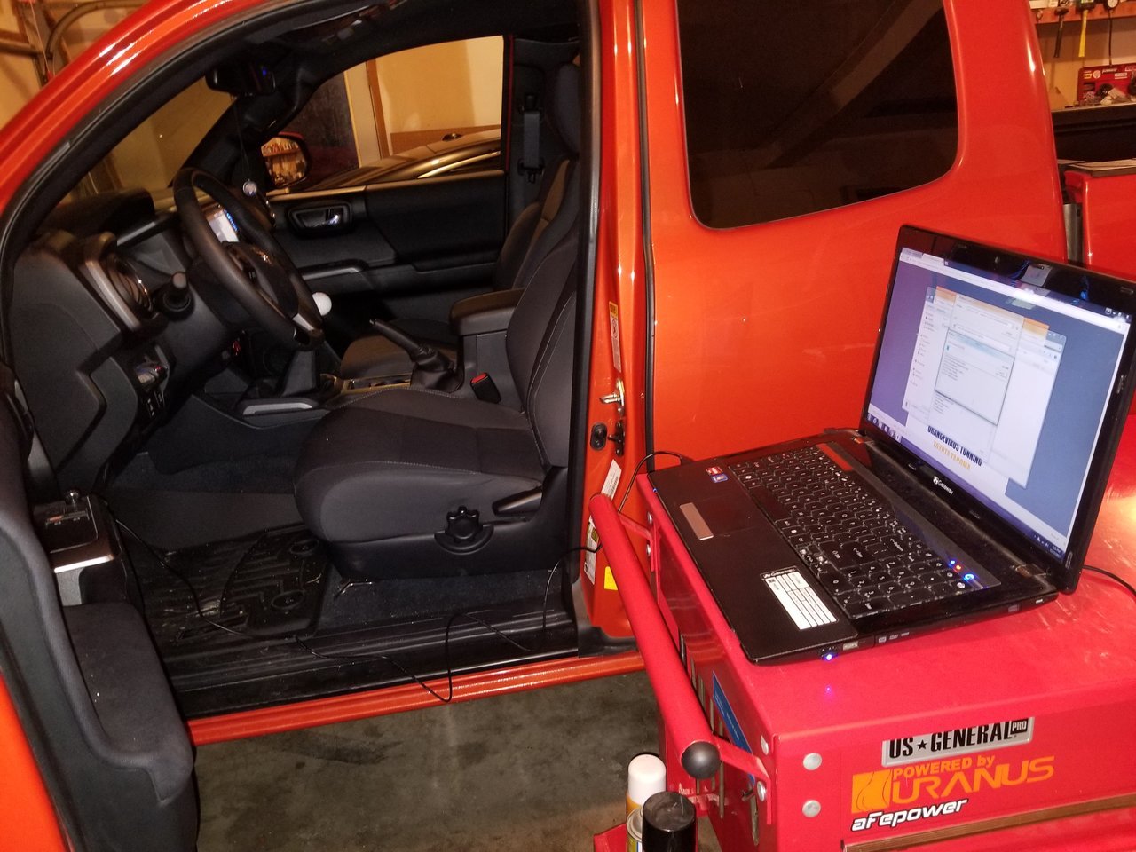

    On the road now with a cold engine right after Flash. I have an hour drive plus errands to run in an hour drive home. I will report back later.
