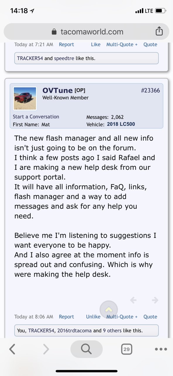

    My post #1027 my dealer was reluctant but I showed him these pics. After he saw these they flashed my truck.
    Just my experience.
    https://www.tacomaworld.com/threads/software-update-for-the-manual.562550/page-52#post-18522543
