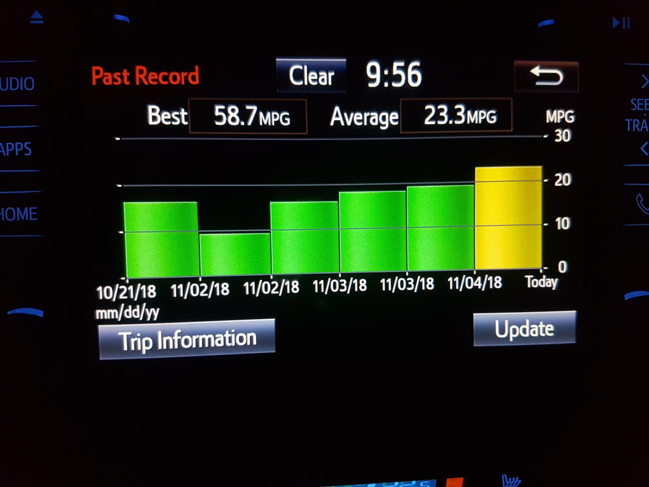

    I flashed tonight to 1.05 FO 91 and had to go run an errand. Trip was only 16 miles of mostly hwy with speed from 45 to 60. The 23.3mpg is off roughly 1mpg because I'm running 265/70R17 so it's actually 24.5mpg.

    Interesting...doesn’t seem like Otto tune impacts mpg that significantly if at all. Any of you other Otto guys see a difference in Mpg?

    I haven't noticed anything in the 100 miles I have on it. I will be hard to really tell though as temps are dropping over the next week or so and winter blend fuel.

    That’s cool and all but anybody can post about extraordinary MPGs on a short trip.
    Enjoy 1.05 and report back after 300+ miles
