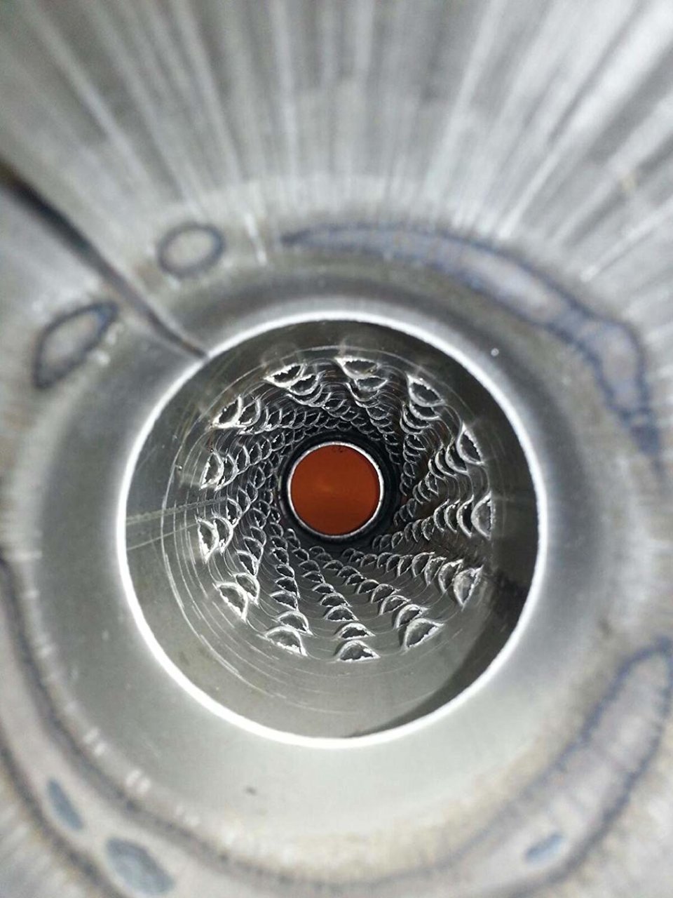

    Just a quick update, I have been running the 1.05 FO 91 since it came out. I finally got around to putting a "resonator" in my exhaust system today. I had been running the flow master dual outlet catback system with the URD cat delete y pipe. I noticed a considerable drop in low end power when I installed the y pipe along with an increase in drone. I installed an 18" 2 1/2" resonator/glasspack in front of the muffler and holly balls the power down low is back with a vengeance and the drone is almost non existent:burnrubber: I wonder if Mat can calculate HP/torque from data logs?
    Glasspack I installed has this design.
