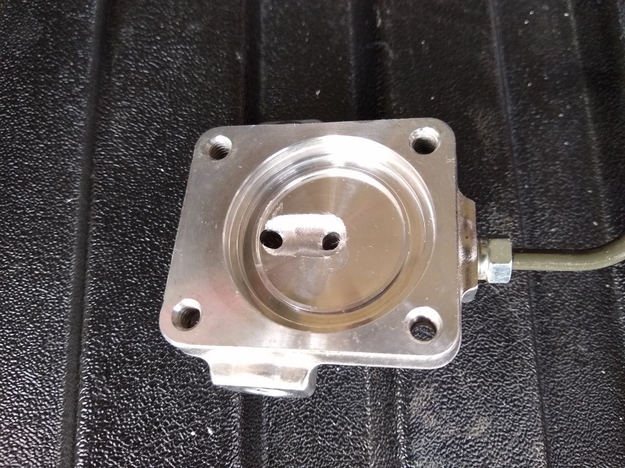

    I bought the kit to bypass the accumulator. Once I got in there I decided to go a different direction.
    I ported the accumulator with a Dremel. Best part for everyone after me, this requires nothing but a Dremel and DOT3.
    Feels awesome! Wish I had done this 20k ago.

    Thanks for doing this and posting the results ! ....... now if we had an experienced hand that could tell us how this mod compares to the " normal " delete ...... ??? ( Someone would have to try both ? )

    I still have the accumulator, but I'd have to rig up a new line from it to the slave cylinder (I harvested the OEM fittings from it).
    There seems to be more than enough "meat" in the body of that POS to cut a fairly deep channel between the two ports.
    My only concern would be getting the whole thing completely free of debris...
    Anyone else wanna try this?
