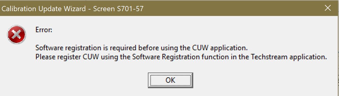

    Gone through several times. Downloaded TS and followed all steps. Everytime I go to open CUW file it shows me this:

    Make sure TS is up and functional before using the CUW file. You should be able to open TS and verify it can connect to your truck. Once thats done, then the CUW file will work.
    Assuming you are using the tactrix dongle, if you have those drivers installed in the TS setup you can skip all the driver install steps and just select the tractrix interface when you open TS
