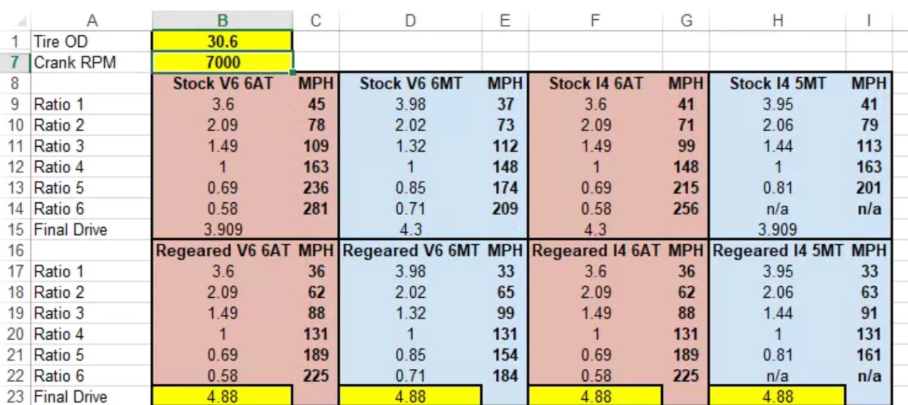

    I attached my Excel sheet for anyone curious about ratios and rpms.

    Nerd Alert: Apparently, tire OD specs are for an unloaded tire; so, when you put the weight of the vehicle on it you lose about a half inch of radius (or about an inch in effective diameter). It's best to use the revs/mile spec if you can find it.
    For the stock Off-road "30.6 inch" tire it is 682 revs/mile which gives an effective diameter of 29.57". Of course, the effective diameter would probably increase a bit at 169 (or 201) MPH before it abruptly decreases to 16".

    On the nerd side, there is also tread wear constantly changing the speedo ratio. A long time ago, I think I calculated that to be about 2% for motorcycle tires (new to completely worn)?
