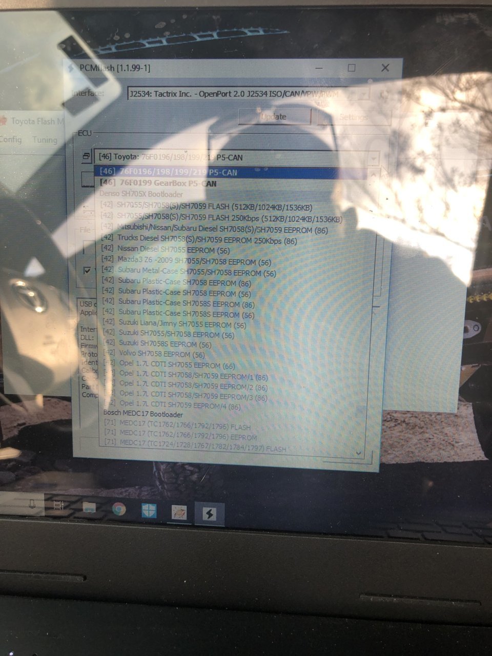

  17. Feb 19, 2019 at 1:57 PM
    #9957
    su.b.rat
    su.b.rat broken truck
    Jul 30, 2016
    #193316
    9,869
    and as mentioned above you can make an exception in Defender for the directory
    tonered likes this.
  18. Feb 19, 2019 at 2:08 PM
    #9958
    Trident904
    Trident904 Touching Drum Sets
    Jun 13, 2014
    #131875
    5,089
    Brian
    Treasure Coast, Florida
    17 4Runner TRD OR
    Modded it so much it turned into a 4Runner
    Which drop down menu item do we select in this part?
  19. Feb 19, 2019 at 2:09 PM
    #9959
    su.b.rat
    Jul 30, 2016
    #193316
    9,869
    P5 CAN under Toyota toward the bottom
  20. Feb 19, 2019 at 2:12 PM
    #9960
    Trident904
    Jun 13, 2014
    #131875
    5,089
    Brian
    17 4Runner TRD OR
    That’s what I thought. Flash was crazy fast. Got it done though.
