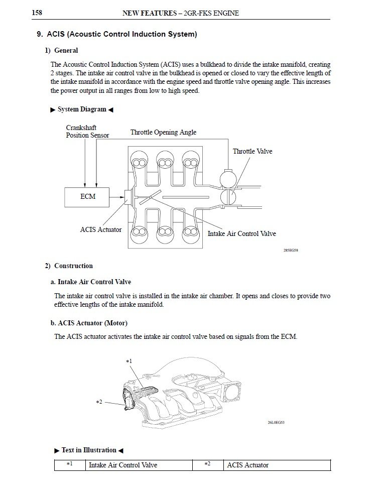

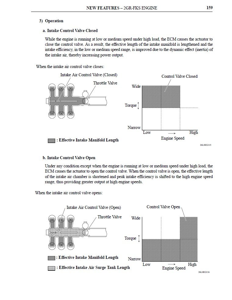

    The 2GR-FKS uses a system called ACIS (Acoustic Control Induction System). A bulkhead valve is either open or closed, which changes the effective intake runner length. Not sure if that can ever be smoothed out perfectly.
