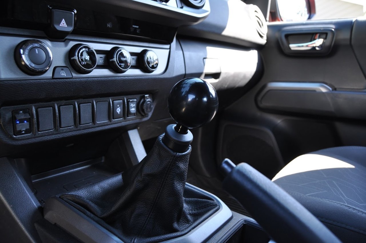

    I got space for a button:
    I've been slacking on some planned mods, but a sweet OVT button would be hilarious. Or, maybe a button that has this on it:
