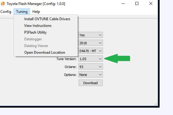

    Purchased OVTune a few months ago. Downloaded all the information for tune. I tried to install the software last night but worried because I did not see my "stock" factory tune in the Tune folder. The only tune that was in the folder is the 1.05 tune. How do you save the Stock tune to retrieve it at a later date? Or does it download the stock tune when it uploads the 1.05 tune. I would like the option to upload the stock tune when taking it to the dealer. Damn, was so ready to get this done last night, any help will be great. Thanks

    Click the button that says 1.05, and choose "stock" from the drop down menu.

    duh - Thanks

    Done -wife's truck is running so much better. Power is just right for this truck.
