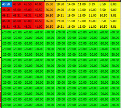

    For the issue of rev hang. We are addressing this from multiple avenues, including developing our own table to help solve this.
    Testing for 04B13 will be available likely by this weekend >
    This table takes into account current Torque value for request (in conjunction to throttle code) and Current throttle position for 0% accelerator + Clutch in
    Ignition will be retarded to help with the rev hang. There is a default safety limit @ 1600 RPM so that ignition will recover to stock idle below 1600 RPM.
    A dongle users RAM dump made this possible. Thank you
    WalkinTaco, 02Duck, Tachord and 13 others like this.

    MY HAND IS UP FOR 04B13 TESTING OF THIS..
    Well, once I stop "using" it.
    :D
    Putting my dongle down now.
    @OVTune I'm also very encouraged by the fact that you're using "clutch in" data for this. The digging around in this area of the calibration may lead to a solution for another pet peeve of mine.
