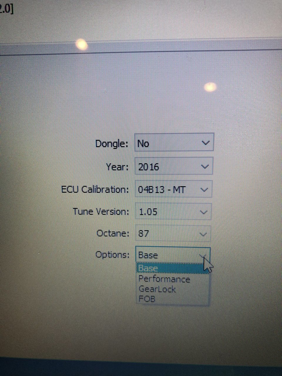

    I believe I’m ready to flash for the first time. Just wanted to double check the options. As a manual transmission the only 87 octane options are “base” and “FOB”? “Performance” and “gear lock” are for autos?

    Correct.

    That is where I am happiest so far.
    Yes. P and GL don't apply to us.
