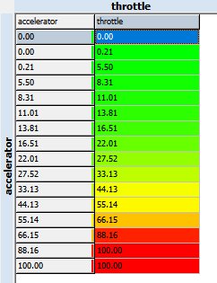

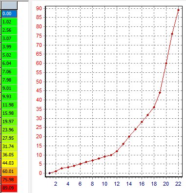

    I Think I may know what you are seeing / feeling at low throttle control. Give me a moment I'll show you a few tables that could be the culprit
    iexc, MOC221_ and Melmantaco like this.
  18. Jun 11, 2019 at 12:59 PM
    OVTune
    OVTune [OP] Well-Known Member
    Mar 27, 2017
    #214557
    8,112
    OVTune
    So, putting aside the multiple 3D tables that create the "demand" requested.. (these are stock tables)
    here is your base throttle scaling. (basically X volt = Y angle)
    It's not a smooth scale at all.
    Then, you have independent gear throttle limit tables (angle to accel angle)
    These tables are referenced then modified by multiple 3D tables at the same time, but the "base" (scale, cal) isn't really "great" on it's own.
    iexc, MOC221_, Melmantaco and 2 others like this.
  19. Jun 11, 2019 at 1:19 PM
    tonered
    tonered bartheloni
    Sep 25, 2017
    #231055
    31,247
    tony
    Lynnwood, WA
    Gawd. Is it me, or does that seem dumb?
    What would life be like if the first graph was linear other than the first couple points and the second just identical for all gears and neutral?
    I suppose that I just dream of old multiport EFIs. Or, the simple throttle cam profile on my bike.
    iexc, TD90S and MOC221_ like this.
