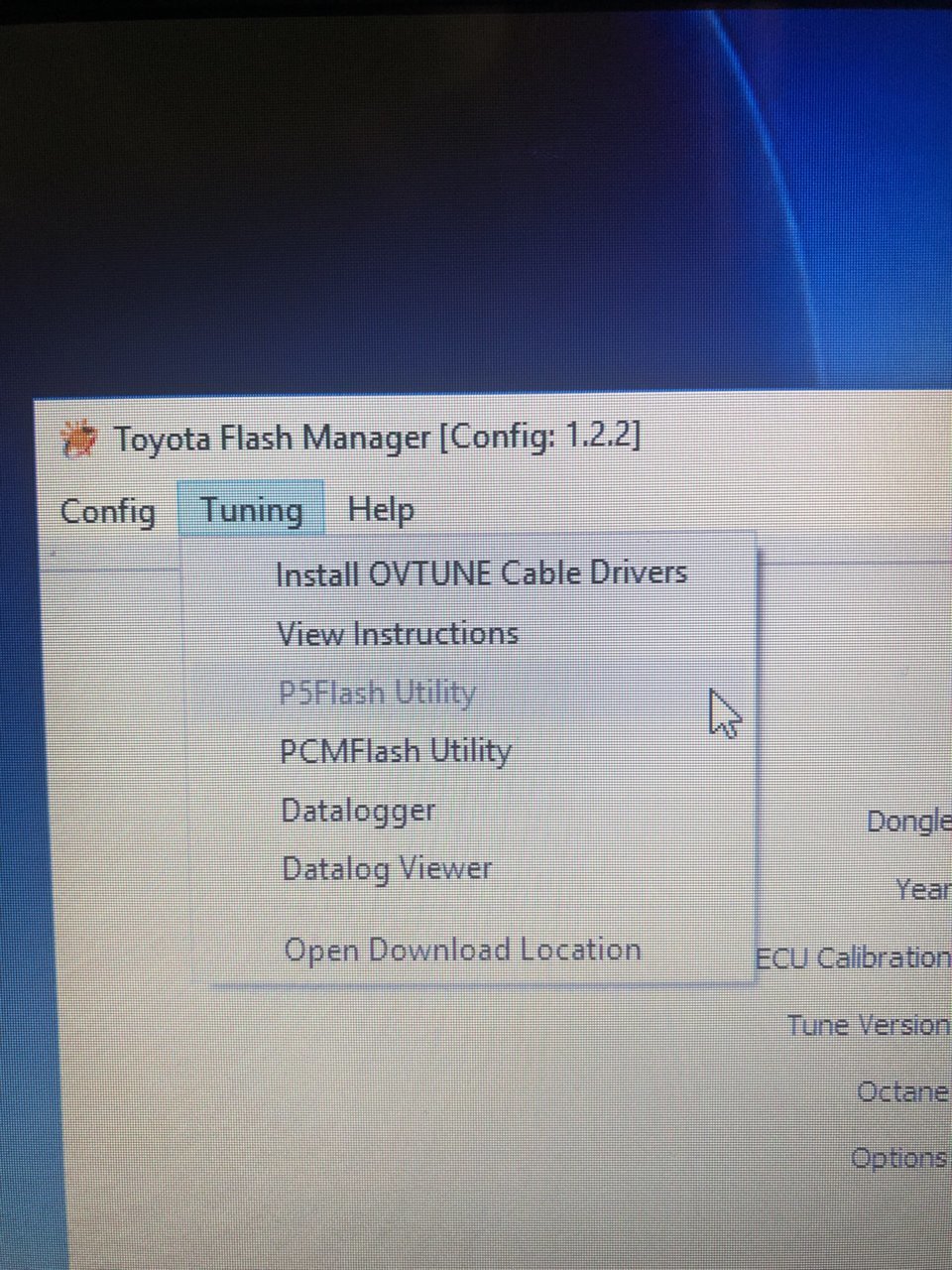

    I just flashed with 87 FOB. I was going to reset the ECU learning after I flashed but P5Flash Utility is greyed out. I could get into it before I updated the OV tune software. Has the feature been disabled once updating or is something else weird?

    Iowa
    P5 flash is for dongleless users
    PCM flash is for dongle users
    Which one did you use to flash your truck?

    I had the same, make sure your OS and drivers are all up to date, it should solve the issue.

    I wonder if it had a problem downloading the new p5flash when it updated. Did you try updating again in the flash tool? You could search your OS for p5flash, you should have an exe somewhere that is named something like p5flash_1.2.2.exe.

    I don’t have the dongle. When I clicked the PCM flash I got an error saying couldn’t find single which makes sense. But then P5Flash is greyed out
