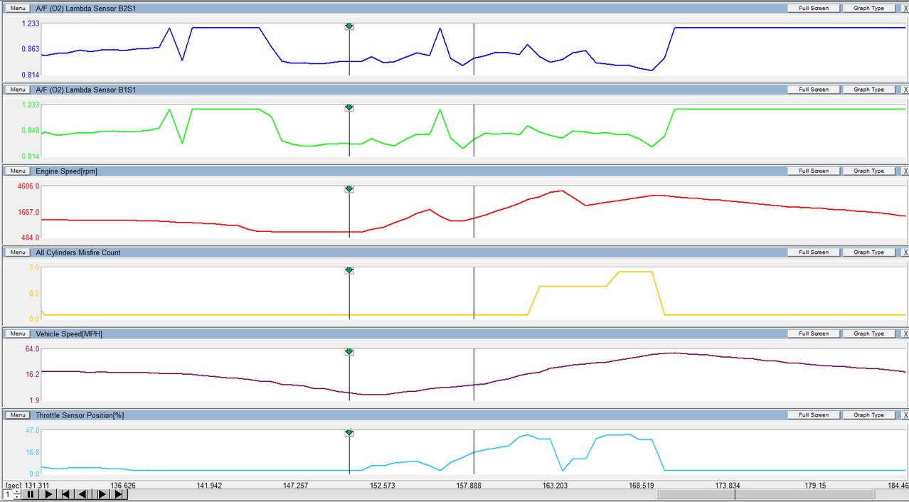

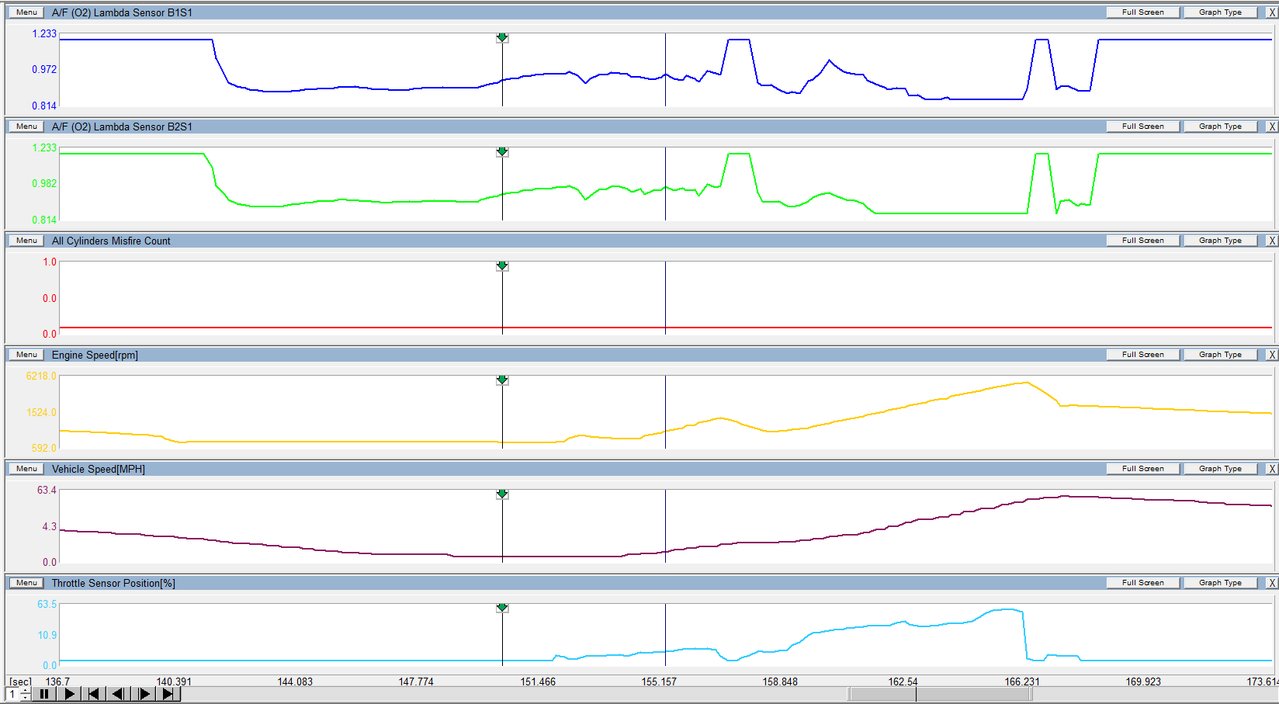

    91 tune is also driving crappy again. At 40+ % throttle input it starts breaking up in between 3-4k and records misfires in techstream. Stock tune does not do this at all, but the throttle mappings are noticeably worse on the stock tune. Attached is a second gear pull WOT on the stock tune, you can see the throttle input is 100% but the ECU limits the actual throttle opening quite a bit, but there are no misfires. Still waiting on OVTune to get back to me.

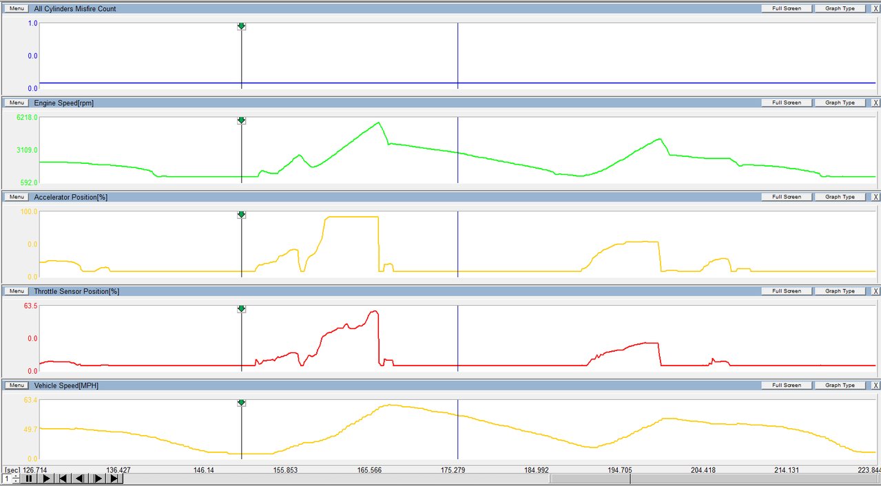

    Your other post with the OVT didn't show the Accelerator Position to compare the mapping to the Throttle Sensor. The stock tune looks like it lags and gets worse the deeper you go into the pedal. I'm curious to see what the OVT looks like? How much better does it map and does it allow a greater max opening? 63% max seems way low.

    Sure attached, keep in mind with the misfires im not going WOT but it gives a decent idea on the mapping. Another issue is that since its misfiring the ECU is probably pulling throttle out of it so it may not be entirely accurate unfortunately.

    Thanks. That seems to be a much better match. There are a couple interesting over-shoots though? It looks like that is where the misfires are happening?
    Myself, I still struggle (read: pisses me off) with electronic throttles that WOT at the pedal doesn't equal WOT at the TB.
    Good stuff! Sorry for the trouble that you are having though.

    Are you able to determine which cylinders are misfiring? The graph references all cylinders but I'd be curious if it is a specific set of cylinders each time that experience the misfires. I wonder if it's a timing issue or fueling issue that could be causing spark blowout and therefore a misfire is logged. Do you feel or hear the misfires?

    Lynnwood, WA
    The individual cylinders were shown in the previous post:
    https://www.tacomaworld.com/threads...gine-ecu-reflash.515734/page-68#post-16796225

    Ok, sorry missed that post. But it is only showing 3 of the cylinders so I'm assuming the other 3 did not report a misfire.
    Am i right in reading that the count was 1-2 per cylinder? The above graph showed in all cylinder count that did not go above 3. I'm not familiar with the Techstream software that is why i'm asking.
    Every vehicle will see random misfires once in a while under full throttle. A single digit misfire count on a cylinder is nothing to worry about.

    The others did not register misfires. The issue is there is a noticeable drop in power as the engine breaks up, when the ECU detects misfires at high load its going to pull timing the throttle back to protect itself. It falls on its face as the misfires start occurring as well as me leveling off on the throttle to protect the engine. Im not interested in poking a $41k truck with a stick to get more misfires to pop up without being on a dyno with an AFR sensor without any proper tuning software I can use to monitor the thing. The stock tune rarely records a misfire in techstream, maybe one or 2 per mile or so even at WOT as shown in the above screenshot.
    Edit: I honestly wouldnt be shocked if most other trucks running 1.03 have this same issue im having and either dont realize it because they dont know what it feels like/know what to look for or its not as severe.

    Gotcha. Odd. That graph is just vague on the misfires. Yes they're there but it's hard to correlate in counts per revolution.
    Agreed that if it's acting up definitely don't stay in it. I also agree it'd be better to have it on a dyno with a wide band to really see what's going on.
    Does techstream at-least capture the narrow band voltage? I'd like to see if you're above or below current lambda.
    I also wonder if timing and fueling map is off and you're getting spark blow out. Might need to narrow the gap on the plugs. You could pull a plug on a misfiring cylinder and see how it looks. Might give you some insight.
