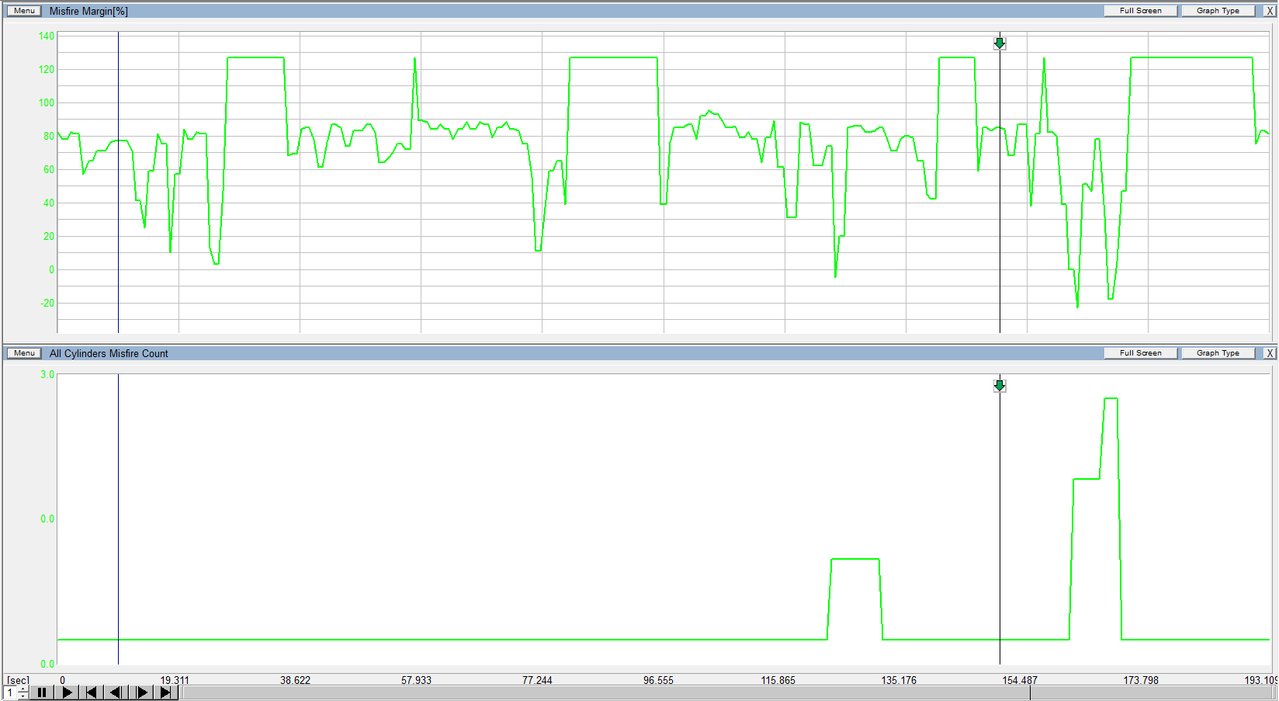

    What exactly does "Missfire margin %" mean?
    Edit: After looking at the data more closely, I'd assume it means that the closer you are to zero, the more likely a missfire is (actual missfires correspond). So this is due to incorrect A/F under load?
    Also, although the all cylinders missfire count graph looks bad, the vertical axis maxes out at 3. Is there a multiplier? Is this per unit time?
    I'm not trashing your data, I just want to understand what I'm seeing.

    When a misfire occurs the counter holds that misfire for a total of 100 revolutions
    MOC221_[QUOTED] likes this.

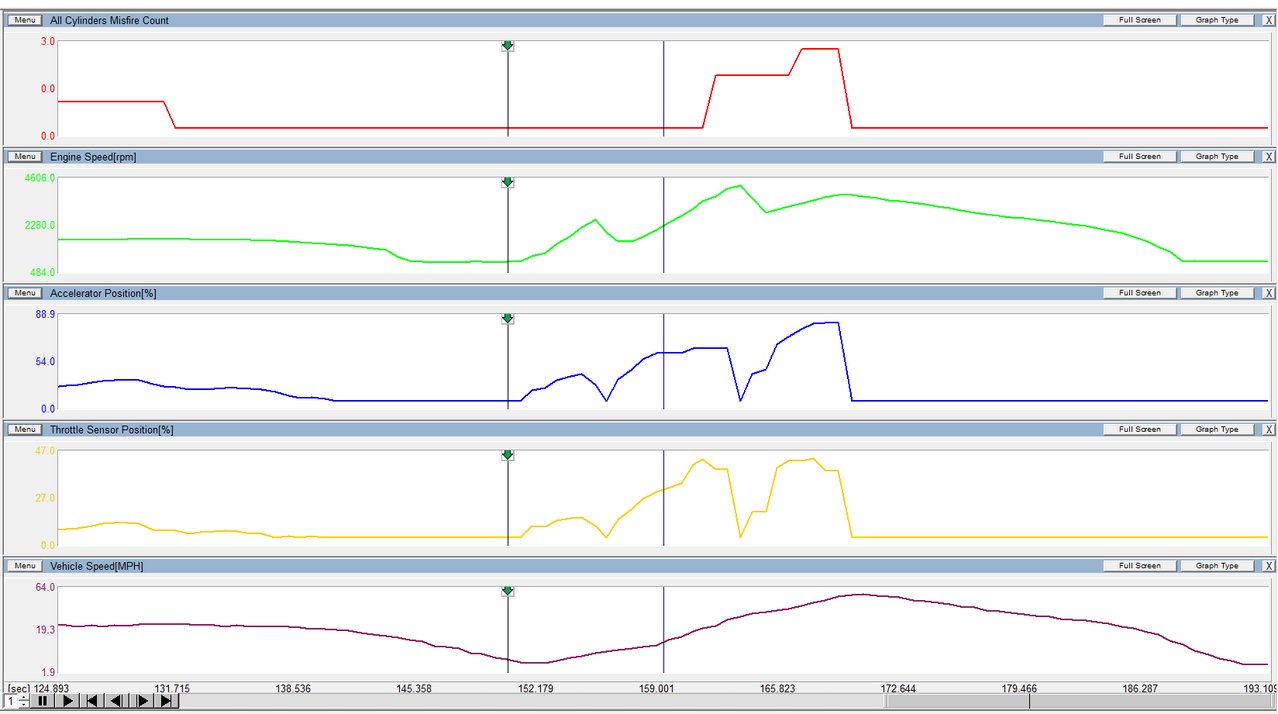

    I think I know what you are talking about. If you lean on the throttle some but don't downshift, you are talking about the hesitation it will do? On the stock map you can't really feel it of you lug the engine some. On the tune, it will kind of jerk the truck. Is that it? The 87 tune did not mesh well with my truck. It would literally backfire.

    No not at all. The stock tune has shitty throttle maps. Thats separate then the misfires on the OV tune. What Im saying is that since the Ov tune is misfiring its pulling back timing and throttle to protect the engine so the values seen in those screen shots are probably not accurate compared to when the OV tune doesnt misfire. When it doesnt miss I would expect input throttle to output throttle to be closer to 1:1.
