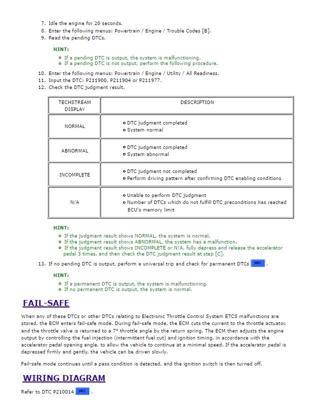

    Here's my rambling about DFCO.
    Way back in Post 441, I tossed in this graphic from my Torque app:
    https://www.tacomaworld.com/threads...gine-ecu-reflash.515734/page-23#post-16413059
    The gauge labeled throttle appears to be the actual throttle plate and the min / max marks seem to agree with what @luminous posted.
    Since all EFI cars have DFCO, which I happen to like the principle of, I have never had a problem with it's function whether it is a slushbox or MT.
    So, I am wondering if DFCO is the real problem or that the throttle plate hanging open at 17% while coasting is the real issue? When the fuel pops back on, the mixture at 17% throttle is going to feel a lot different than 3% throttle.
    When I set up the EFI on my motorcycle after a service, the TPS is baselined at 0deg and the idle stop is set right around 3.5deg (3.9%). Of course, it doesn't have a DFCO function. I'm just using that as an angle reference.
    Both the min and max throttle plate angles bother me for different reasons. I wonder what folks at altitude are seeing for min / max?

    So if I understand correctly, you're saying that there could be an undesirably high volume of air flowing into the engine at the moment fuel injection begins again - causing a surge?
    Hmm, I'll have to set up a PID to look at the throttle angle in various conditions.
    I can tell you one thing though, the "closed" position for our V6 throttle butterfly seems to be 7 deg, if I'm reading this description of fail safe mode (read:limp) correctly:

    Yes. A large volume of air plus fuel to make the AFR match.
    7deg sounds reasonable. I've had motors go into limp mode a couple times. Not a fun situation. Both acceleration and coasting did feel different. But, the last time was many years ago.
    It would be good to see what you find. The TPS and throttle opening are standard functions, so you should be able to get the data easily.
