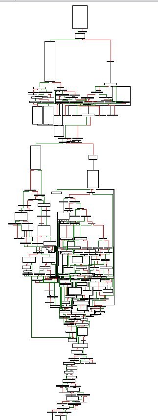

  10. Jan 21, 2020 at 7:43 PM
    OVTune
    OVTune [OP] Well-Known Member
    Mar 27, 2017
    #214557
    8,112
    OVTune
    The Port injection, Direct Injection, Split injection code is what sent me down this code rabbit hole.
    So, with DFCO there are a few components,
    2-6th gear is controlled separate than 1rst gear
    There is also an additional injection amount added on initial refueling.
    the code will take me a little longer to sort through.
    The flow chart for it.
    mind boggling.
    also found the code to change the target AFR to whatever we want.. make it run leaner..richer all the time, etc. Make it leaner or richer depending on temp..
  11. Jan 21, 2020 at 7:48 PM
    Shellshock
    Nov 21, 2015
    #170338
    23,628
    Iowa
    Holy fucking spaghetti
  12. Jan 21, 2020 at 7:57 PM
    tonered
    tonered bartheloni
    Sep 25, 2017
    #231055
    31,339
    tony
    Lynnwood, WA
    That's a whole lot nicer word than what I was thinking. How the hell does this engine even run with decision trees like that.
  13. Jan 21, 2020 at 7:58 PM
    M1Awolf
    M1Awolf Well-Known Member
    Jun 16, 2017
    #221701
    2,192
    Rob
    Montana
    2017 TRD Off Road DCSB M/T
    It sure explains it's bipolar schizophrenic behavior though...
