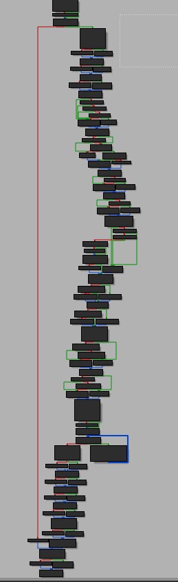

  7. Feb 9, 2020 at 3:55 PM
    OVTune
    OVTune [OP] Well-Known Member
    Mar 27, 2017
    #214557
    8,112
    OVTune
    okay, it's in here, so not too bad of a code routine.
    Help me understand what it is that happens.

  8. Feb 9, 2020 at 4:03 PM
    OVTune
    Mar 27, 2017
    #214557
    8,112
    OVTune
    04B13, p5f
    please let me know if this affects throttle.
    It's based on gas pedal angle
    Edit this might be neutral related
