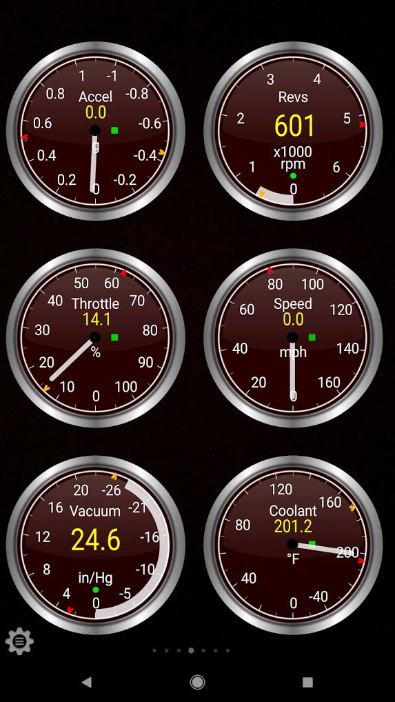

    I was up around 3,200ft altitude yesterday. It looks like either it wasn't high enough to get any compensation for the throttle or it compensates for altitude somehow else:
    The throttle did close a bit further, but still only opened to about 63%.

    Interesting.. so you'd expect greater opening angles to compensate for lower pressure?
    On my end, I've been playing with Fusion and logging some PIDs WRT DFCO. The problem is, no matter how I configure the software, the best update frequency is about once every two seconds. I've set the logging trigger to fixed time intervals instead of GPS or PID frames, but all that does is give me a shitload of data that's exactly the same. I was attempting to use multiple graphs with the same time base to illustrate what was happening when you lift of the throttle, but because of the crappy "2 second rule", some transitions were offset from each other or missing entirely. TBH, i may be monitoring too many PIDS (14). I was gonna try reducing that to about 5 and see if it makes a difference:

    Yes. I was expecting bigger at WOT and maybe lower when coasting to maintain the same coasting deceleration? I live at about 400ft and drive at sea level daily.
    On Torque, I see that green lights near the center of the needles flash when it updates. It seems to be between 1sec to 2sec depending on the gauge. I think Torque says that it can be altered but could cause problems. They all update at different rates and different times. Fun!
    I am not sure what the limiting factor is there, the OBD device, the port protocols, or the bluetooth bandwidth?
    I do quick scans of the gauges while driving. Logging would be better, but I haven't dug deep enough for that. The current and max / mins usually show me what I want to see. I will try to get a log of a full pull and coast, if I can.
    I think that plotting the data might give us a peak at what is going on even if everything doesn't line up perfectly. Once it is figured out, seeing multiple tries is easy.
