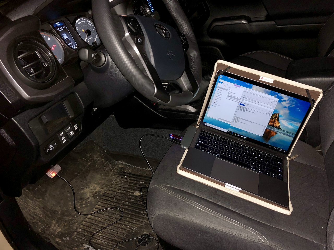

    How are you able to use OVTune on a Mac book pro? I thought it was only compatible with a Pc.

    If you look closely, he's running Windows. It's possible to do that with the fancy Intel processor Macs via split partitions and dual booting. And a purchased copy of windows is required also.

    Boot camp. I run both windows and macOS on my laptop. It is pretty convenient for times when I need something that is only offered on windows.

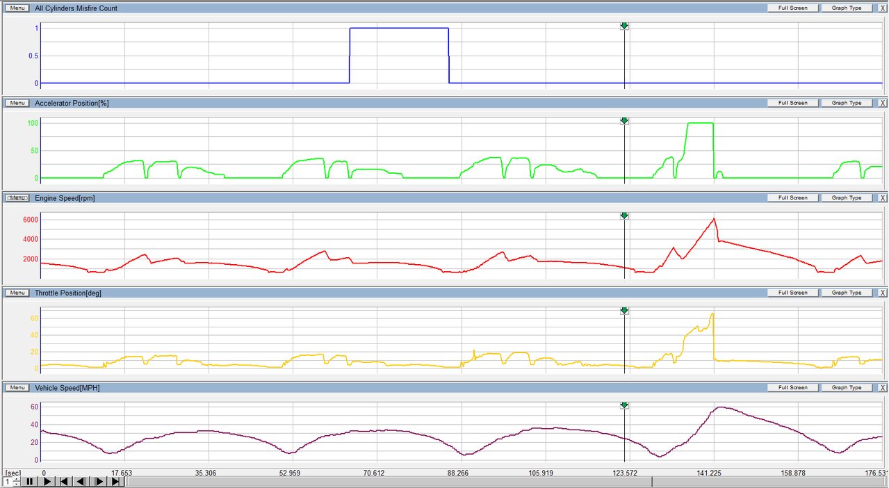

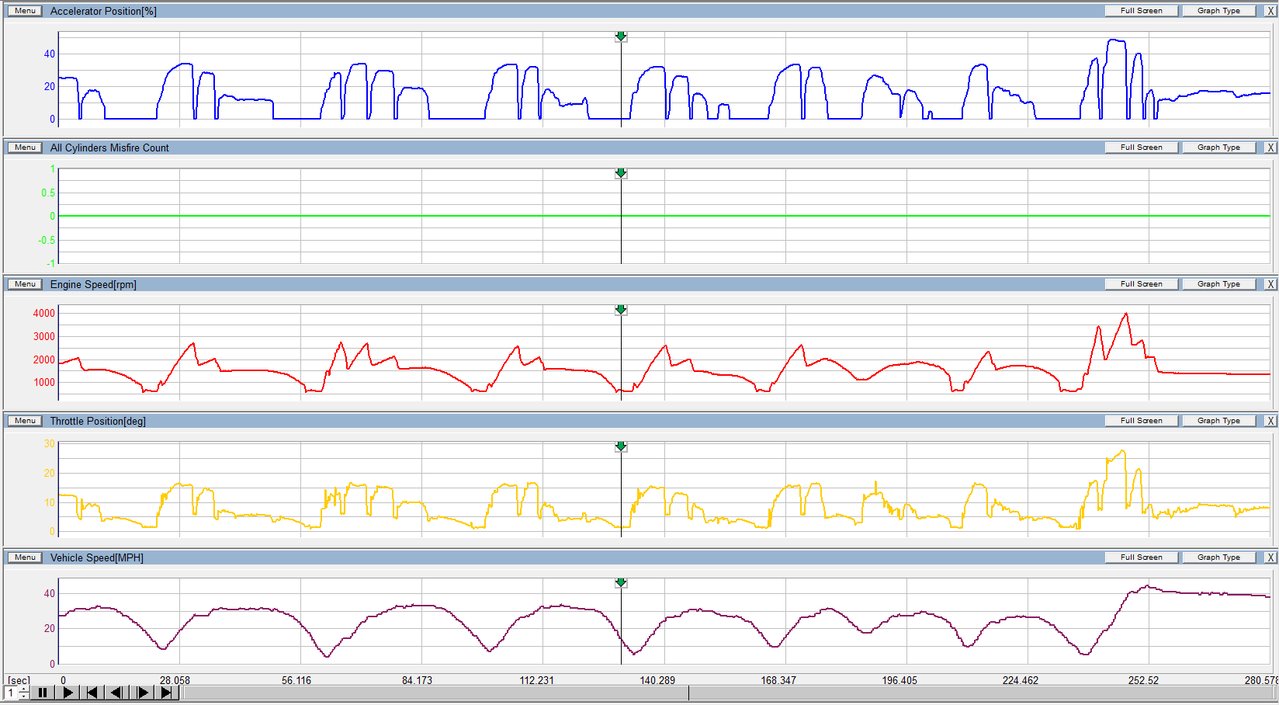

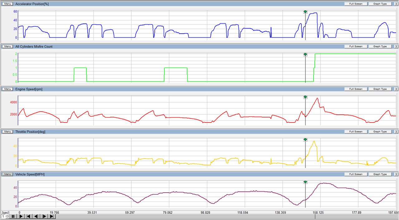

    Got an updated tune file from Matt a few days ago and I am still seeing misfires in between 3 and 4k at 40-60% throttle. Under normal city driving, and even WOT its totally fine but not at moderate loads. I've asked Matt if I can get the stock tune with just the throttle mapping changes, hopefully its possible since thats really my biggest complaint with the truck.
    Normal driving:
    WOT:
    Moderate load:
    tonered and MOC221_ like this.

    Are you testing 1.03 or 1.03B?

    Its labeled as 1.03.

    It also looks like the throttle plate position is much more closed while coasting (much less than 17%) on this tune. Does it feel any different?
    Along that line, I was following an MT WRX this morning. Twice approaching stop signs from 35mph in normal driving, my Taco slowed faster while downshifting compared to the WRX. I am not 100% sure that they were not feathering the accelerator, but we were both dropping through the gears. In 2nd, I was slowing much faster and opening up the gap almost to idle.
    Maybe the weak engine braking is just in my head?
