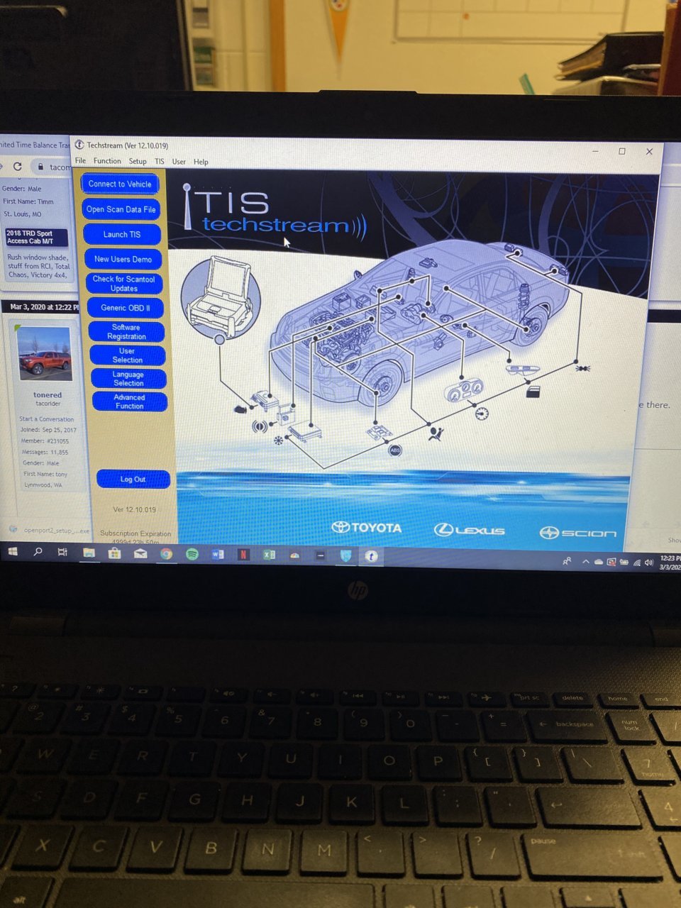

  3. Mar 3, 2020 at 9:22 AM
    tonered
    tonered bartheloni
    Sep 25, 2017
    #231055
    31,138
    tony
    Lynnwood, WA
    You should see the Tactrix option in the connection dropdown menu. Is this the same computer that you use for OVT? If so, it should be there.

  4. Mar 3, 2020 at 9:26 AM
    Woodzyzewski
    Woodzyzewski Well-Known Member
    Jul 21, 2014
    #134383
    341
    Woodrow
    West Virginia
    2018 Inferno TRD Off Road DCSB
    This is the screen I’m shown. Idk where to go from here. My OVtune cable is plugged in. This is the computer I tuned with. All the drivers are installed. Anything I click on this TS page is a failure lolD721D4BD-18B6-49F4-B77F-21968B8DDB5B.jpg
    tonered likes this.
  5. Mar 3, 2020 at 9:28 AM
    tonered
    tonered bartheloni
    Sep 25, 2017
    #231055
    31,138
    tony
    Lynnwood, WA
    Ah! You cannot get a connection unless you are hooked up to your Taco. When you hit Connect to Vehicle, you will get a connection prompt with a drop down to select the OpenPort / Tactrix drivers.

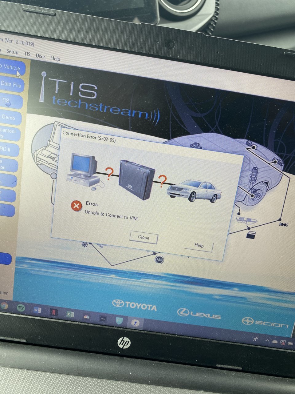

  10. Mar 3, 2020 at 9:38 AM
    Woodzyzewski
    Jul 21, 2014
    #134383
    341
    Woodrow
    West Virginia
    Plugged into the truck and when I hit connect to vehicle it says Unable to Connect to VIM
  11. Mar 3, 2020 at 9:39 AM
    tonered
    tonered bartheloni
    Sep 25, 2017
    #231055
    31,138
    tony
    Lynnwood, WA
    Did you pick the OpenPort / Tactrix drivers from the connection drop down menu? Is your key on?

  13. Mar 3, 2020 at 9:45 AM
    jlkphoto
    jlkphoto Member
    Mar 2, 2020

  14. Mar 3, 2020 at 9:46 AM
    Woodzyzewski
    Jul 21, 2014
    #134383
    341
    Woodrow
    West Virginia
    Fellas. I’ve done it with the key on and key out of the ignition. I’m not seeing any drop down connection options. I hit “connect to vehicle” in the picture I posted above and get this. image.jpg

  15. Mar 3, 2020 at 9:48 AM
    OVTune
    OVTune [OP] Well-Known Member
    Mar 27, 2017
    #214557
    8,112
    OVTune
    Tomorrow I will be releasing for testing:
    04B13
    2.0 FULL.
    (P5F)
    for independent tests.
    4low, WalkinTaco, Rainman70 and 8 others like this.
  16. Mar 3, 2020 at 9:48 AM
    Shellshock
    Nov 21, 2015
    #170338
    23,315
    Iowa
    up in one of the menus in the top menu bar you change the adapter. I dont remember the name 100% but its up there.

  19. Mar 3, 2020 at 9:53 AM
    Woodzyzewski
    Jul 21, 2014
    #134383
    341
    Woodrow
    West Virginia
    Okay. I’ve got it connected to my truck. Now it’s asking me make model and engine and 2018 is not an option for Tacoma and I have no idea what 2TR-FE means for the engine option. Does this matter if I hit next?
  20. Mar 3, 2020 at 9:56 AM
    pinochle
    pinochle GC8 Fanatic
    May 15, 2017
    #219061
    1,456
    NNJ
    2018 TRDOR DCSB 4x4 6MT
    NFab Nerf Steps, Bakflip MX4, Profile 5500K HIDs, Kicker Tweeters, Toyota Bed Mat, XPEL Ultimate Paint Protection, Borla S-Type Catback Exhaust, ME-SO Customs Gasshole, ME-SO Customs Total Tails Stage 1, ME-SO Customs Ultimate LED Turn Signals V4, HELLA Supertones, OVTuned 2.0, 2LO Mod, 16x8 0mm Enkei RPT1 Wheels in Titanium Gold, Diode Dynamics SS3 Pro Foglights, K&N Cabin Air Filter, HPS Intake Hose, Amsoil Gear Lubes in 6MT, front and rear differentials, XPEL Prime XR Plus Tint, TRD Engine Air Filter, Pioneer Head Unit, 275/75R16 Falken Wildpeak A/T3W Tires, RallyArmor UR Flaps
    Keep digging! It's there!
    tonered likes this.
