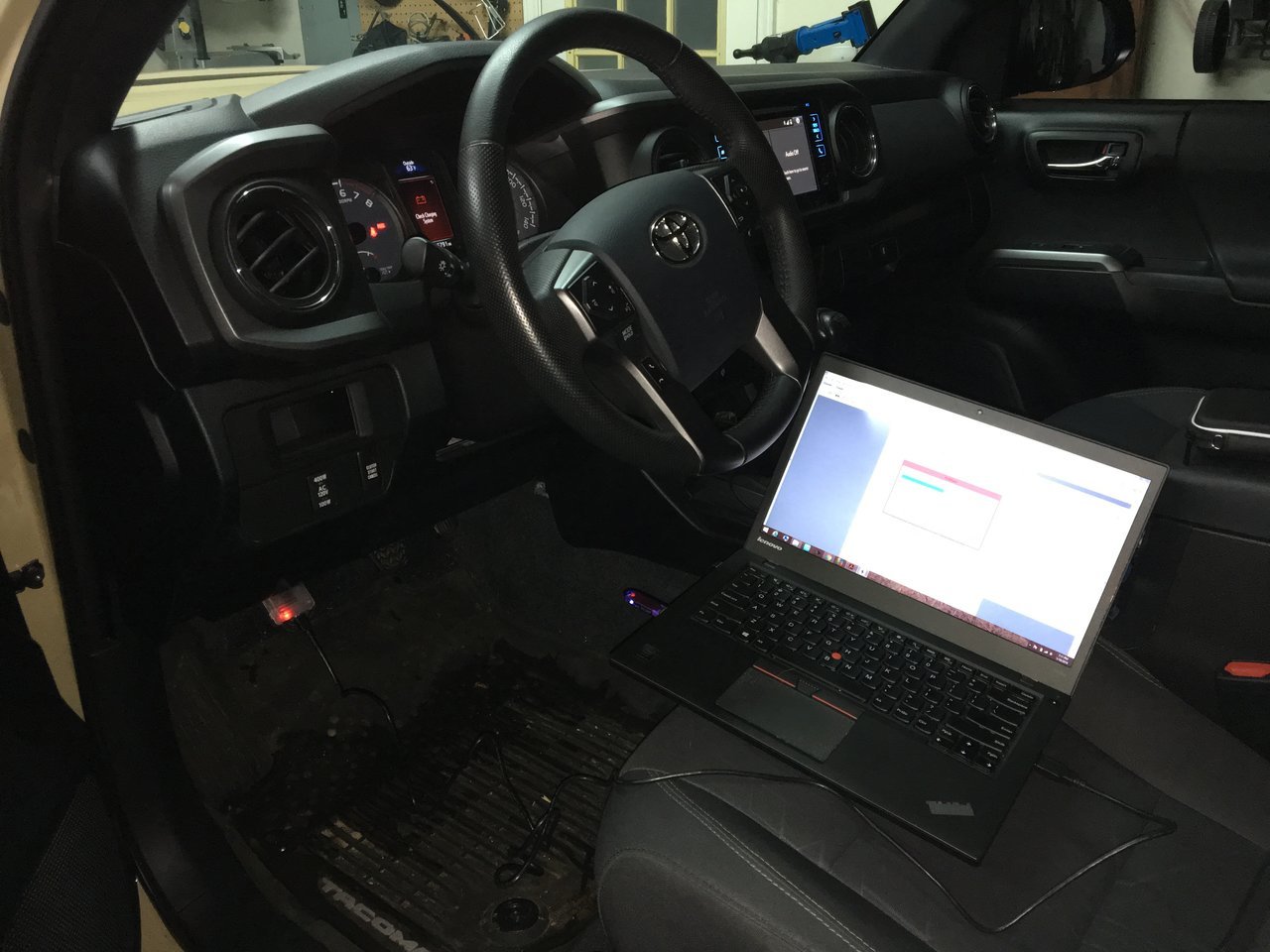

    In the process of reading ECU for the first time...
    Build date: March 2016 (Texas)
    04B11 :dancingbacon:

    ha ya...i was sweatin. It was killing me because it took over a week to get my pcmflash serial key. Time to drink a cold one.
