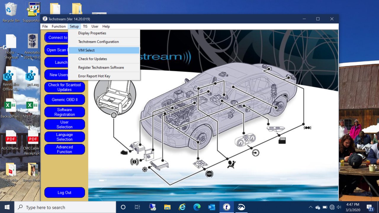

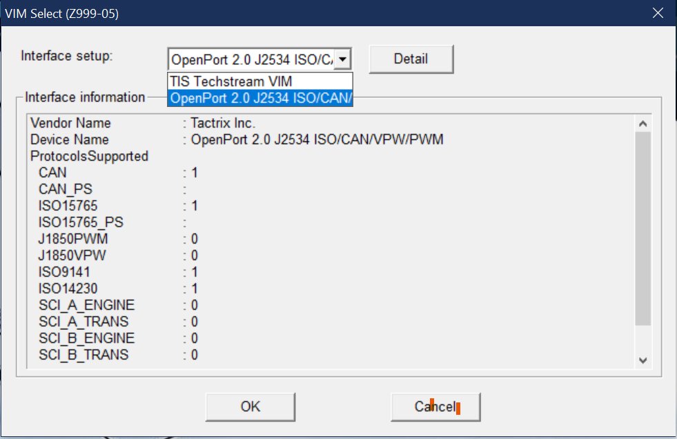

    Hey... I finally figured it out, I just needed to select Setup -> VIM Select; then drop the "Interface setup" box to OpenPort.
    Thanks to everyone for the tips that got my blinker change working :thumbsup:
    I saw earlier today a PDF that someone posted and it explained all the available customizations. I can't find it for the life of me now o_O anyone know where that is? I was hoping to find something to change the sensitivity or delay for dimming the display when I pass under an overpass. I doubt there is a setting for it but I'll remain hopeful until I find otherwise.
    Wish I had found this info and tried the TS TSB update before I tried to convince my local dealer to take me up to 04B13. I couldn't get them to do it under warranty, and they had me on my heels so I paid something like $100 for them to install the TSB :(

    Hey there it is. I knew it was one of those menus :thumbsup:
