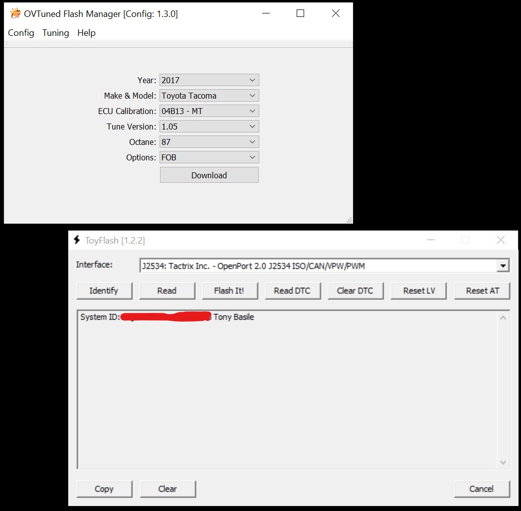

    Here we go.

    :eek: time to steal tony's system ID!
    not that i could do anything with it lol

    so its reset lv AFTER flashing

    Could you edit your post to blow away my Sys ID? I saw that and edited just in case. :D

    Flash, verify the engine starts, off, back to on (engine not running), hit DTC and LV Resets, and the 5min idle.

    Tony, what is the DTC button for? Don’t remember any mention of resetting that one.

    Diagnostic trouble codes

    It clears the stored diagnostic codes and resets the emissions readiness cycle.
    Interesting. Be sure to hit the updates in the menus, i.e. Install All Software, Install OVT Drivers, and Help / Update.
    Also, this version installs in a new folder that you might need to whitelist.

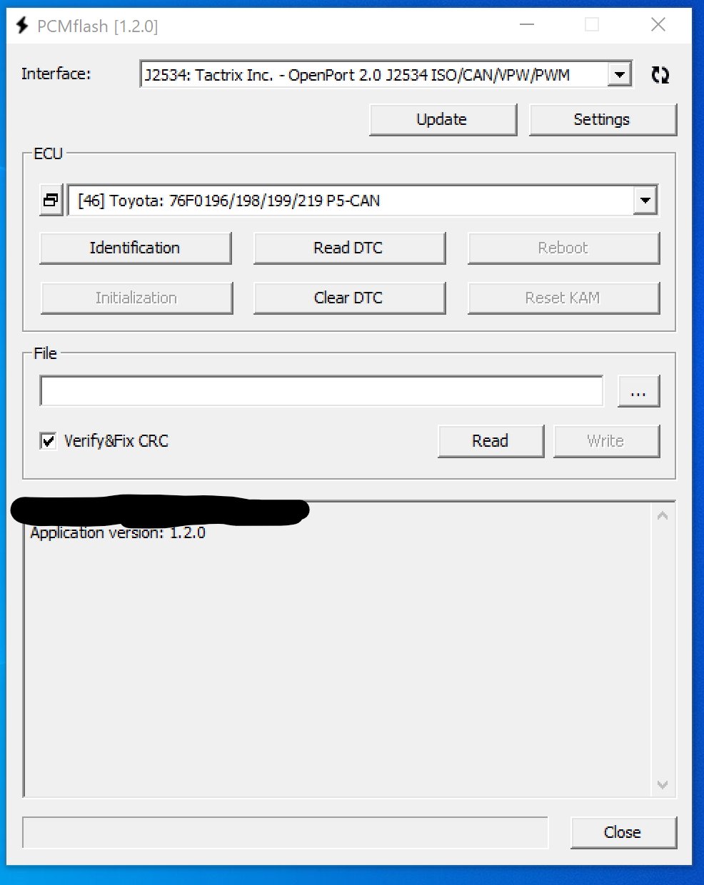

    whitelist a new folder?
    tonered[QUOTED] likes this.
  19. Mar 6, 2020 at 7:59 PM
    CorbinDallas
    CorbinDallas Well-Known Member
    Aug 17, 2019
    #302467
    378
    Corbin
    Tacoma
    16 MT OR
    This is my utility:

    Yeah. The old folder was Toyota Flash or something like that. The new folder is OVTuned?
    Sorry. I shut down.
    I know on my side, Windows Defender picked up on some part of it.
