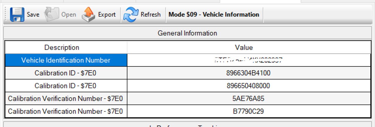

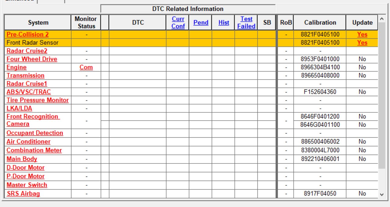

    How do I find the current ECU version of my stock truck? I looked in OBDwiz and Techstream, both latest versions, and wasn't able to easily see it. Perhaps some kind soul could tell me if it is in either of these screencaps? Or is there better OBD software to use for this?

    You're 04B41
    Top pic, 2nd row.
    89663 04B41 00
    We're calibration twins.

    Thank you! Wasn't sure and didn't want to mess up. So it appears I need to flash the pre-collision sensor TSB, per Techstream...correct? And if I do that it will then change my ECU ID won't it? If so, is there a way to tell what the new ID value will be prior to the flash?

    It should be the yellow highlighted rows in the TS screenshot. It has a Calibration code but there is no "B" in it. That one is the TSB that says that due to the placement from the factory, water may get into the front collision sensor and cause it to randomly slam your brakes on. I really don't understand why Toyota didn't make that a recall...

    Ok so I read about that procedure regarding the PCS radar on the government site, and I misunderstood your original question regarding Cal ID, in the context of this thread.
    04B41 is your "ECM" cal ID, which we use to determine which OVT files to flash (engine/transmission management)
    There are of course other ECUs in your truck (like the PCS) that have separate and completely different software and thus Cal IDs.
    Did you have the physical part of the TSB done - applying the sealer?
    Has the radar unit been changed out?
    I'd have a good read of the complete document before doing anything...

    I had forgotten that the ovtune software is only licensed to the current "ECM" (engine) control unit calibration version. Thus, it appears that when viewing the Techstream reports I only need to concern myself with the "Engine" row for the purpose of determining whether there is a TSB that needs to be applied which will force me to purchase more "credits" if I update.
