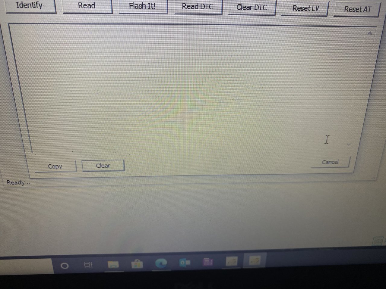

    What is the reset lv and reset at button?
  5. Jul 27, 2020 at 4:43 PM
    Double Phister
    Double Phister Punch it Chewie
    Jul 23, 2017
    #224795
    588
    Sacramento, CA
    2017 DCSB TRD OR [SOLD]
    It zeros out the Learned Values (engine) and Automatic Transmission values
    Usually done after a flash to a new tune to start things out fresh.

    I just flashed it and will see how it goes. When it try to clear lv and at it says completed unsuccessfully. What does that mean? Thanks
    tonered likes this.
  11. Jul 31, 2020 at 9:07 AM
    tonered
    tonered bartheloni
    Sep 25, 2017
    #231055
    31,239
    tony
    Lynnwood, WA
    The LV Reset needs to be key On without the engine running. I do not know if it is the same requirement for the AT Reset. The DTC Reset does not care.
  12. Jul 31, 2020 at 9:21 AM
    smiles2
    smiles2 Well-Known Member
    Oct 9, 2017
    #232453
    189
    2017 Blue Tacoma TRD Offroad
    I was able to reset it. Thanks
