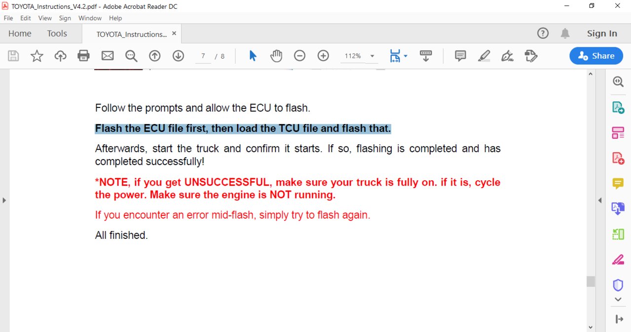

    So I have flashed my truck multiple times experimenting with different octanes and just flashed once more this morning. I noticed something in the instructions I never noticed before. The instructions towards the bottom of the PDF state, "Flash the ECU file first, then load the TCU file and flash that." It is my understanding when I open the Toyota Flash Manager and go through the procedure of downloading the file to my laptop then flash my truck that this satisfies the entirety of flashing your ECU. At this point I start my truck let it idle for 5 min and I'm good to go... right? What is the TCU file? Have I only been completing half of the tune procedure? Thanks in advance.

    You don't have a TCU to flash anyway, you've a MT.
    That's for AT and it's old, they don't need to flash a second file anymore
