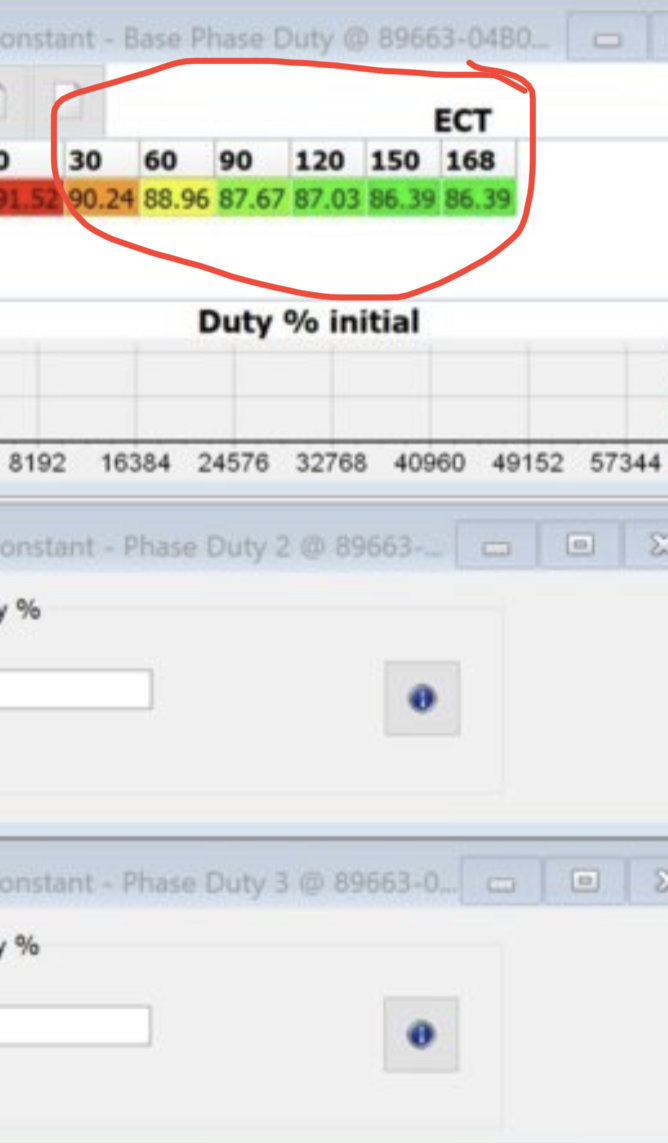

    there was a test tune Mat made to verify we could alter the output. That post has what was in that test tune compared to stock.
    The settings in base phase duty will change the voltage output, then you raise the duty cycle to accommodate that extra output. Mine is at 94 from 30 and up and gets me 14.4-5v. I raised the duty cycle approx 20% across the board. Once you flash, you can verify the voltage in the data logger.
    I’ve been running this for a while now and haven’t had any issues.

    As explained best by @mZiggy
    the alternator will be working harder to produce the additional output, so by increasing duty, you should be compensating for that.
