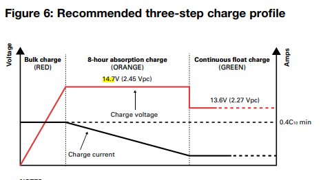

    Yo so I'm.way behind. I flashed a while ago and forgot about it and moved on. I've been running 14.6-14.7 volts for a few months with no issues. I frequently drive 2-3 hours to wheel it. It's not often we drive more than 4-5 hours. Am I at any serious risk of anything? I remember Odyssey telling me their AGMs love 14.7v FWIW

    So far not a single person has reported to us any battery failures after tuning the alternator settings. I think melmantaco wants to just look into in a "just in case"

    I would think the best check would be to plug into the OBD and monitor a trip or two. See if it exceeds 14.7v and how long it might. A bit more or a bit less is no issue.

    Pretty sure you cannot exceed 14.7 volts, there is a hard limit in the ECU if you go past 14.7 you get a check engine light
