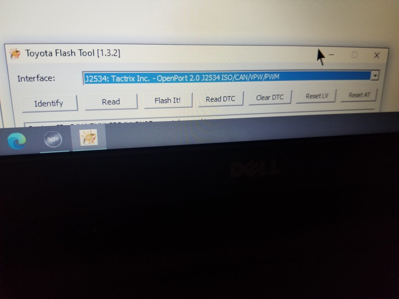

    Also, you guys keep on talking about DTC and "resets". Where do i find these "resets" and is it a big deal if i cleared DTC only?

    They are in the Flash Tool. DTC is typically reset when you flash or pull a battery cable. Any OBD total can do it also. The LV Reset is the big one. Doing both cleans the slate. Reset them and idle for 5min, touching nothing. Drive for 10mi+, then cycle the ignition. That does the majority of the settling.
    OVT's notes on it:
    "Regarding reset AT / LV.
    So this isn't confusing
    Resetting LV / AT after a flash = not required
    Resetting LV / AT after a flash = is not harmful, and may be done at your discretion
    Resetting LV / AT after a flash = Should be done IF you have drivability issues (very odd shifting behavior, very odd engine behavior, or you hear any knock/detonation)
    Resetting LV / AT after a flash = May make the truck run noticeably rougher for the first few miles (especially the transmission)
    Resetting LV / AT should NOT be done just because you feel like doing it.
    Resetting the LV / AT should NOT be done if you haven't recently flashed.
    If you Reset LV / AT right after a flash = the first 25mi to 50mi, the trucks shifting characteristics can be ignored
    If you Reset LV / AT or even flashed the truck and are making judgements without putting AT LEAST 25 miles on the truck, you are not getting an accurate representation of how the truck will perform."
    CygnusX191 and Junkhead[QUOTED] like this.

    So the LV resets are in a flash tool as well? I dont recall seeing that button there? Do you think i should do it as well? I only drove about 30 miles and only cleared the DTCs.

    Yep. These guys:
    Some folks feel otherwise, but I do the reset and idle up with every flash. The first time that I did it, it made a big difference. Just part of my process now. Coming from Stock, I would definitely do them.

    No need to flash. Just turn on the ignition without starting the engine and hit them.
