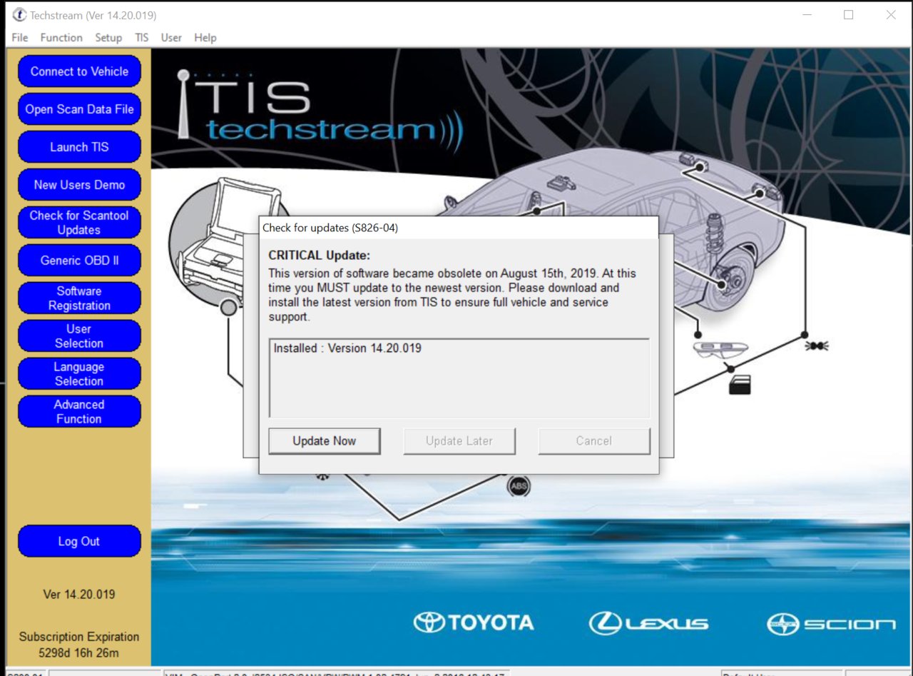

    OVTune [OP] Well-Known Member
    Mar 27, 2017
    #214557
