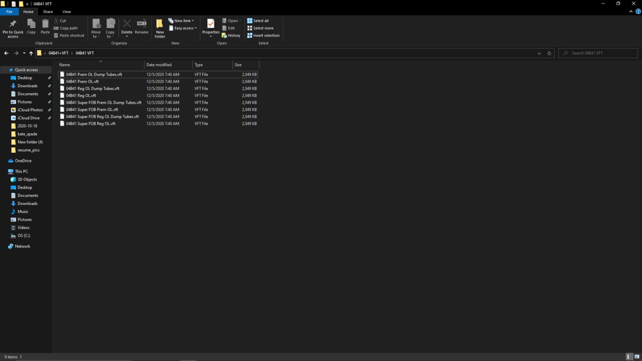

    Hello can anyone give me some help with a brief description of what these files are as I'm about to do my first flash. Thanks.

    So. Many. Stickers.
    Ignore the dump tubes
    Reg OL = Octane Learning, starts with reg gas
    Super OL = same, starts with a higher octane setting
    Premium = you get the idea
    SFob = powahhh!!!!
    Honestly, since this is your first go around, roll with reg OL and see how you like it after a few tanks.

    Thank you does Reg Super Premium pertain to octane grade. I'm currently fueled up with 91.
  12. Dec 5, 2020 at 7:19 AM
    mZiggy
    mZiggy Honey badger
    Apr 8, 2017
    #215707
    4,709
    Marc
    2020 MGM Tundra SR5; 2020 4R TRD Pro; 2008 4R SR5 v8
    Reg and Premium refer to fuel/octane.
    Super refers to Full Otto, and it's "super" because it's the titties. Mat's better version of Full Otto version B
