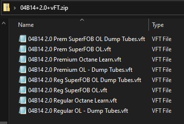

    This is the 04B14 TP. All MT TPs are similar. We have the Base and SFOB (performance) tunes as well as the Reg / Prem ignition set points. The Dump Tube tunes are only for folks who have those.
