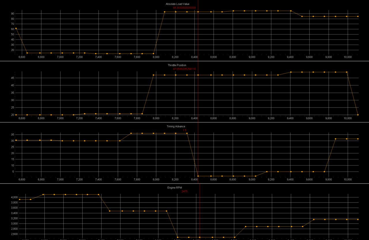

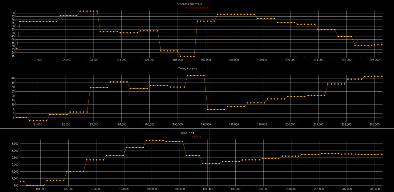

  18. Feb 23, 2021 at 2:59 PM
    92ehatch
    92ehatch Well-Known Member
    Jun 9, 2019
    #295818
    841
    Kinley
    Hendersonville NC
    2019 Cavalry Blue DC TRD OR 6MT
    so i didnt log today on my way home from work, and ended up having that horrible jerk at 1800 rpm that caused the whole truck to buck, damnit, of course it does it when im not logging.
    anyway, i logged this morning and had a pretty good jerk/lunge when shifting from first to second gear. I pulled off and stopped the log so i could find it easier.
    here are a couple of snips.
    what i noticed (if it is anything at all) but after first gear runs out, i let out of the throttle, shift, and get back on it. After ive gotten back into the throttle, the timing is in the 40s then dumps to 4.5 degrees.
    It just seems like the timing is a little late to the party. I understand why it changes, just that its a bit late to decide what to do i guess. Not even sure if this is the cause but figured id post it.
    also, i found out, if you click and hold, and drag from top left to bottom right on the csv viewer, you can zoom in. if you click and hold and drag from bottom right to top left, it will reset the zoom
    also, for the sake of it. I loaded up 2.0 regular SFOB 2 days ago so i could log without any of my changes skewing anything. This file is unmodified

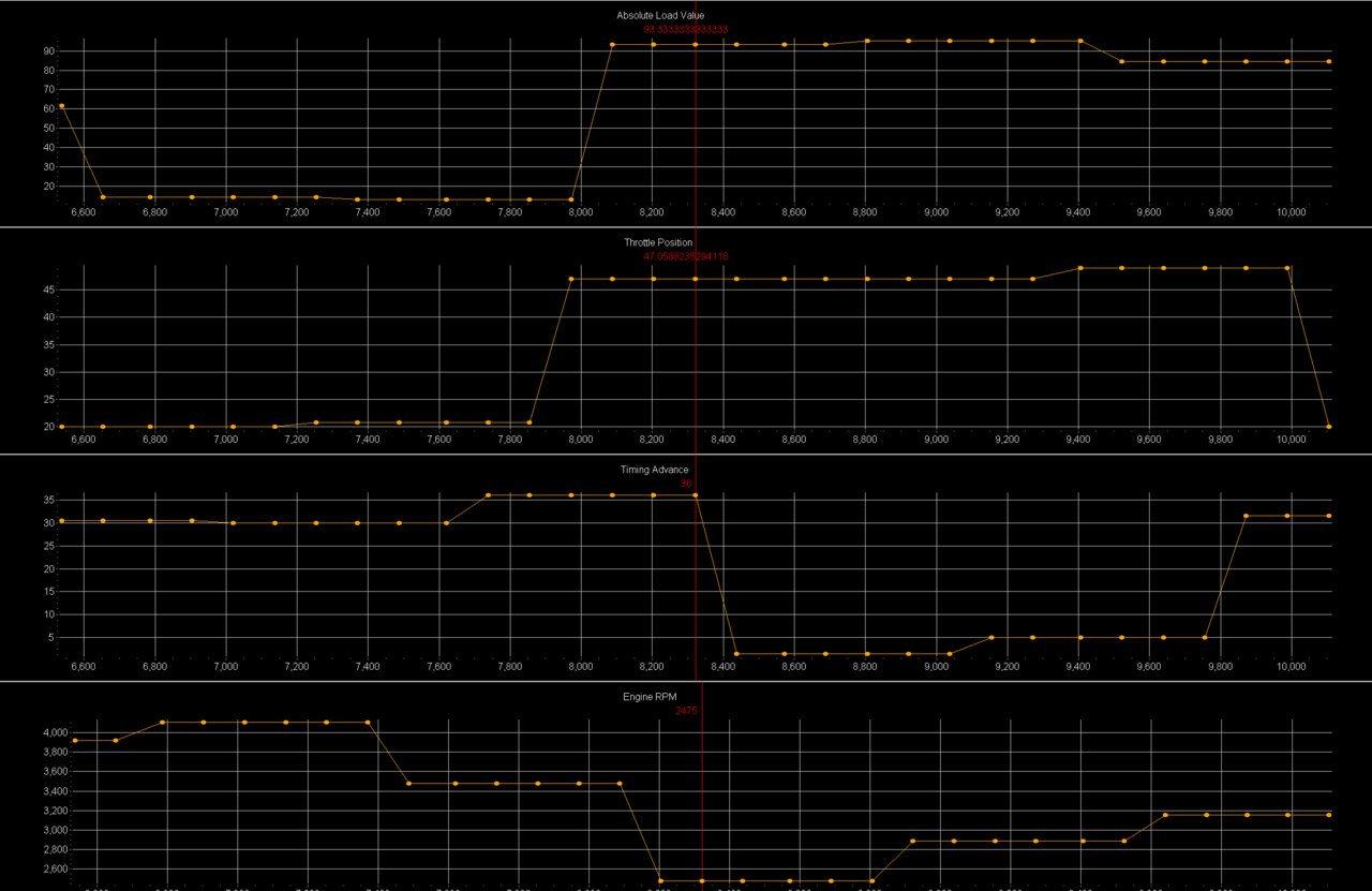

  19. Feb 23, 2021 at 3:09 PM
    92ehatch
    Jun 9, 2019
    #295818
    841
    Kinley
    Hendersonville NC
    for the sake of it, here is another one i got this morning.
