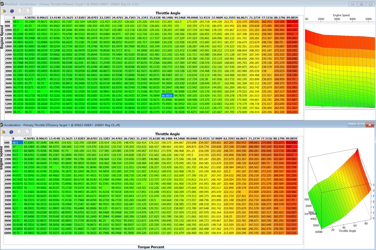

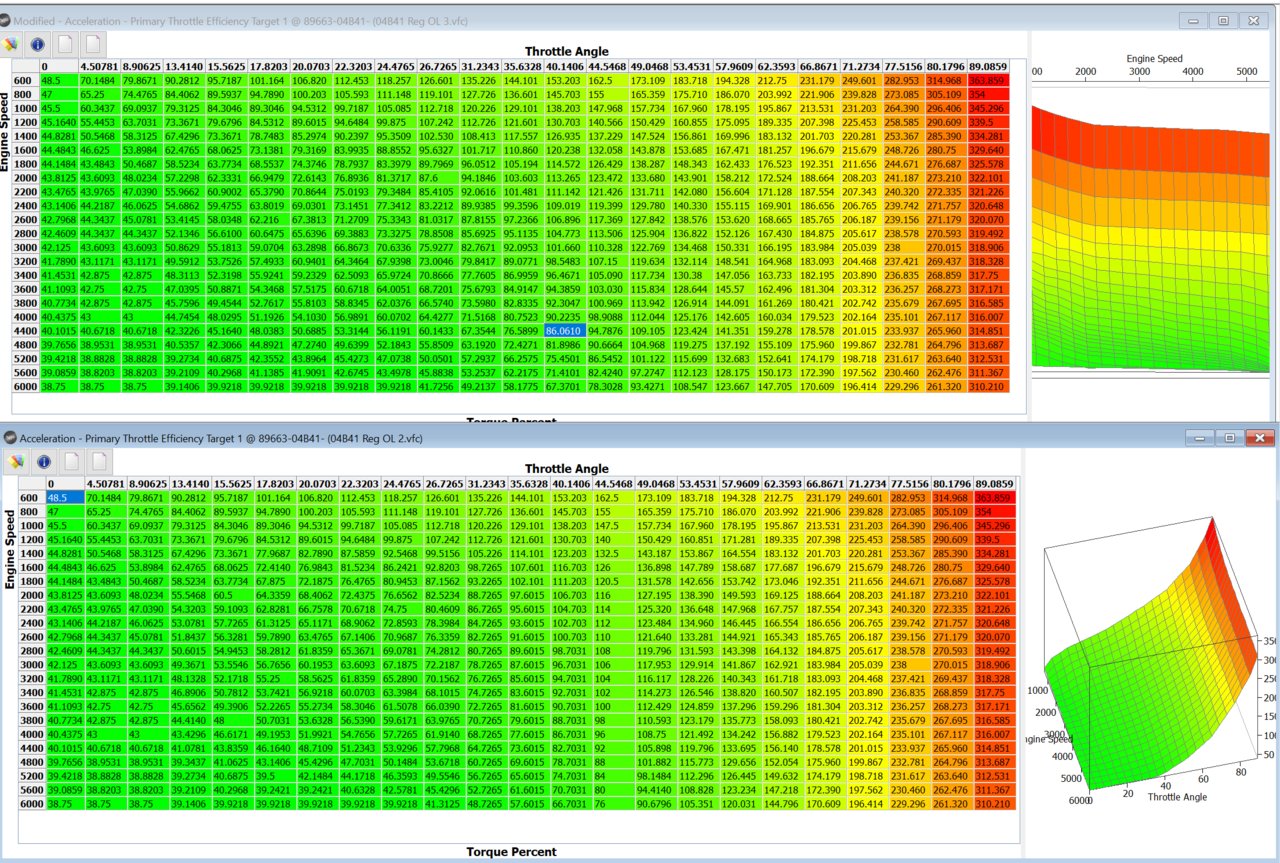

  5. Mar 16, 2021 at 3:38 PM
    92ehatch
    92ehatch Well-Known Member
    Jun 9, 2019
    #295818
    841
    Kinley
    Hendersonville NC
    2019 Cavalry Blue DC TRD OR 6MT
    For example, here is the one ive been working on this week.
    Top picture is the next version compared to ovtunes.
    bottom picture is the next version compared to the one i posted earlier today.
    I'm slowly increasing values until i find a balance between controllable throttle and manageable rev hang.
    this has been a long slow process, im selecting RPM ranges where i feel flatness and am increasing in 1% increments, then smoothing them out with the nearby cells.
    Im never doing a CTRL I on more than 3 cells at a time, if i need to do 9 cells, i start with the first 3 in a line, move over 1 cell and select those 3, etc.
    Then i do those same areas from top to bottom the same way, 3 cells at a time.
    Also, if you hold your right click button on the map picture and drag it, you can zoom in and out. Also, on the logger, you can zoom in and out. To do it in the logger, left click and hold. Drag from top left to bottom right to zoom. drag from bottom right to top left to reset zoom.
