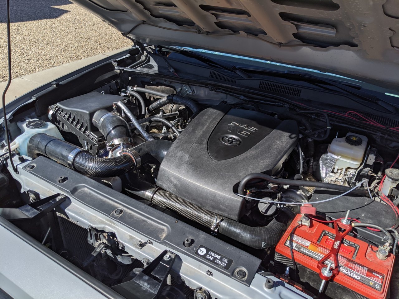

    So, I've been out of this loop for a minute.... You've got a TT3.5 in there?

    Just want you guys to know we have found anti stall controls in the ECU, Anti stall and torque adders which actually kick in all the way from 2000 RPM
    we have also found the tables that control rev hang.
    @tonered will be testing a new map on this and can report feedback further.
    They will be standard in 2.0 Ultimate release, and the tables will be added to VF Tuner with out upcoming update this weekend
