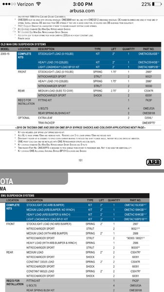

    Can someone help me decide between the stock, medium, and heavy options? Are the rear leafs all dakars? None dakars?

    Whats Your Plans? Bumper, No Bumper? Stuff in the Back? How much are you going to Off-Road? You plan on Towing? Are you a Little Guy or a Love Muffen Teddy Bear?

    195 lb teddy bear. No number initially but might upgrade to one in the future. Definitely stuff in the back. 2016 TRD off road DCLB. Have a all pro bed rack and a CVT RTT to go on top as well as all my camping gear and what not which will be in the back underneath. Don't plan on towing. Plan on going cross country and over-landing wherever I can through all the national parks.

    I would go Medium Load up front because of your weight in the back. I would get the extra leaf for the Dakars for the rear. Also I would run the 5mm Trim Spacer to account for your 195lbs. (Haha. We Weigh the same) :hungry:

    So what this comes with is not the Dakar leaf pack?

    No it comes with the Dakars. Old Man Emu Offers a Add-A-Leaf for the Dakars for heaver Loads.

    Except for the fact that they added the new medium coil Part#2888!

    yup, 2888 coils, same spring rate as 2885 and 2887, 5MM taller than 2887. interesting..........
