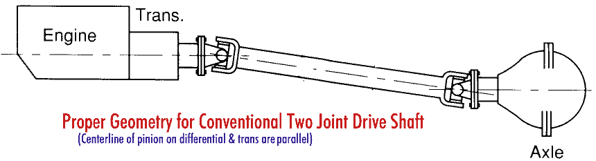

    Thank you again. I suppose the best plan would be to have an angle measuring device and shims on hand so you're prepared. When I do my lift I want to only have to take things apart once.

    Couple things to keep in mind when you do the math on shimming...
    The slope of the 2nd shaft will change slightly as the pinion is shimmed, changing the 1st shaft/2nd shaft working angle.
    The pinion rises under cruising load/acceleration and dives under braking. A stiffer leaf spring pack helps mitigate this some; lift blocks exaggerate it.
    This is why ladder bars are a thing; they keep the pinion from rotating.

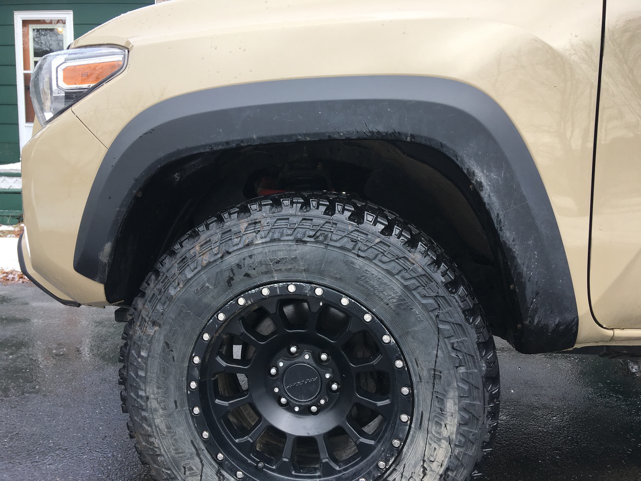

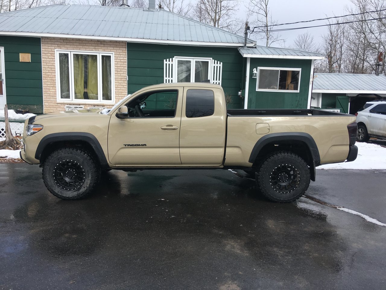

    I’m not an expert but from reading here the squeaking can be fixed pretty easily and avoided the first time you install if you follow afew different options.
    I’ll try to post some pics of my set up. I think the trim packer is the only thing saving me from rubbing up front on the drivers side so probably a matter of time til it does.
    Game plan is to hook up the boat , load the bed with gear and see how much sag I get on the rear. Then come up with a plan to bring up the front enough to stop rubbing, and level the back if/as needed.
    Takes forever to sift through info on here so I’m not sure if I can even add a spacer to this set up. Prob just make some calls to reputable sources. Thing about being in Canada is to save $ you have to go through places that have less than knowledgeable staff to source parts.

    Not sure if you saw my other thread but it turns out my shop installed the collars on my struts upside down. Wtf, the things even came with instructions.... guess I’m half to blame for not double checking but when I got it back it was level and rode great so I never checked. He’s going to re do it at no cost and add spacers if I want them.
    I’m still going through with my plan before that. Got the boat hooked up overnight and will take it for a drive tomorrow and see how she sits.
    Someone mentioned headstrong 1/4” spacers will bring the front up a 1/2” more without sacrificing any performance, but I want to know what the rear is gonna do with that load on it and go from there. Headstrong also has the same 1/2 spacer with studs. I’d rather have the back higher when empty and level when towing if I’m going to sag at all.
    So hopefully just a bit of tweaking and I’m sets

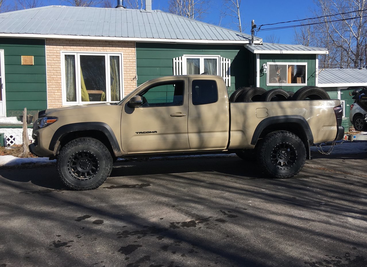

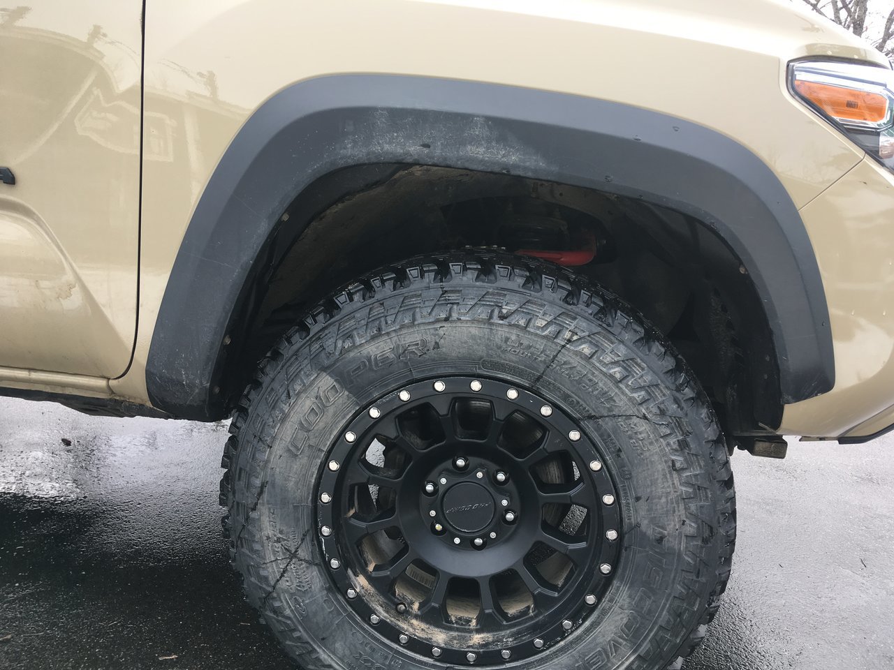

    ok so update after this morning.
    I had the boat hooked up overnight and to make up for some weight that will normally be there but isn't right now (fuel, batteries, gear) I threw 6 tires and about 100lbs of random gear in the back of the truck and 6 more tires in the boat. This will probably be close to my typical towing weight but it will get heavier on the odd trip with firewood/extra batteries etc.
    Here's roughly what I had loaded to tow:
    Boat (hull): 1125lb
    Motor: 359
    Batteries: 1 @ 50lbs
    Trailer:900lb
    6 tires 1 wheel:roughly 180lbs
    total: 2614lbs
    plus in the bed of the truck:
    6tires 120lbs
    gear: 100lbs
    total: 220lbs
    This was my first time towing with the Taco. Took it for a 30min drive up and down some hills and I was very impressed! very happy with the manual transmission and 3.5 here. As far as suspension goes I was also very pleased with the ride quality of the Dakars. Roads are brutal right now with pot holes and it was comfortable. Right now the boat/trailer is sitting about 6" too high at the tongue so it should only get better when I pick up a drop hitch.
    I also marked spots on the driveway then took some measurements and pics before/after the load was on. It is sagging exactly 2" when loaded.
    So game plan is to have the front collars flipped right side up (shake my head) and go without the headstrong spacers for now because I don't want to end up with a bro lean being nose high.
    I'm definitely going to be adding something to the rear to help with the sag. Any suggestions anyone?
    I'm going to poke around there towing threads etc but all my research so far points to Timbrens or maybe sumo, as they offer a couple different kits and I don't want the maintenance of air bags.
    Since the load in the rear isn't constant and I'm happy with the performance right now I also don't think another leaf is a good idea.
    here's a couple pics
    yesterday unloaded:
    Today Loaded:
    DignTRDoffRoadnbama likes this.

    Basically I think it looks exactly like it should with a load like that. If you didn't feel it bottom out you're golden!
    Yea, if it were me and I was towing that much and didn't want to do air bags, I would look at a Load Distribution Bar Kit. They are relatively cheap (good ones are under $250) and if you don't already, if the trailer has brakes, go with a brake controller. That's all you need.
    Something like this:
