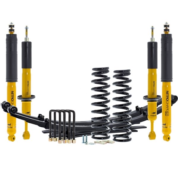

    Kit ordered from @Low Range Off-Road this week. 888 coils and 095 leaf packs. Will post some before and after pics. Thanks for the comments and info in this thread.

    I went with the full OME Medium Kit, nitrocharger OME shocks and struts. I ran an OME kit on my 2nd gen and it was sweet. I spent a fair amount of time debating, but at the end of the day I didn’t want to deal with piecing it all together myself. Plus low range assembles the struts and delivers a package that is pretty much plug and play.
    As of now I only have an ARE camper shell, but would love to get ome of the SOS low profile winch bumpers down the road.
    Edit: I also ordered SPC UCA’s

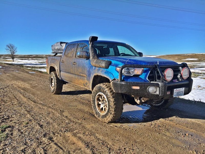

    Hi all!
    I'm looking for your opinions since I'm new to suspension mods. I really appreciate any help!
    I have a 17 TRD Sport 4x4 with:
    • Front
      • Southern Style OffRoad slimline hybrid bumper (steel)
      • Smittybilt X20 9.5k winch (synthetic)
      • RCI Metalworks front skid (steel)
    • Rear
      • SOS Concepts sliders (steel)
      • ARE V-series topper (may replace with Go Fast or Vagabond Outdoors camper down the road)
      • Bed drawers (aluminum) with 3/4" plywood platform filled out with various camping gear
    • Wheels/tires
      • Wheels: 17" diameter, 7" wide, +4mm offset, 4.16" backspacing (Toyota OEM 17 4Runner TRD Pro)
      • Tires: LT265/70R17 (BFG All-Terrain T/A KO2 load range C)
    I'm currently considering:
    • OME OMETAC16HKSB lift kit
      • OME2886 coils and OME90021 soft ride struts pre-assembled (with OME95PF5 front trim spacer for drivers side lean)
      • OME60091 nitrocharger sport rear shocks
      • Dakar EL096R heavy duty leaf pack (with OMESB108 bushings and OMEU53A extended length u-bolts)
      • OMEFK29 carrier bearing drop kit
      • SPC Light Racing 25470 upper control arms
    Questions:
    • Do you agree that the 886 coils and heavy duty Dakar leaf pack are the best choices for the additional weight on my truck?
    • I've been leaning towards the 90021 soft ride struts versus the more rigid 90000 to try to maintain some on-road performance while maintaining capability off-road. Does anyone have any experience with the pairing of 886/90021 or am I better off with the 886/90000?
    • I've gone back and forth on doing the UCAs. I'd prefer to do it all at once but am hesitant on the extra cost. Are they a no-brainer or am I okay without them?
    • I'd like to maintain a small amount of rake while being close to level with the added weight I have. Would any small spacers be needed on top of the coils in addition to the trim spacer for the drivers side?
    • I'm considering upgrading to LT285/70R17 KO2 load range C tires down the road. I'm assuming I'd need a CMC. Do you think I'd have any other issues with the 4Runner Pro wheels based off their offset/backspacing? I may keep the tire size I have but I don't want it to look too silly once I lift it.
    Thanks!
    Photos for reference:

    Excellent freaking post Bro!!!!!!! I wish they were all like this!
    I know a guy that might be able to answer your questions, hey @EatSleepTacos see post above. Thought you might be able to help.
      • I agree that the 886 are a great choice for the front. For the rear, the HD may be overkill. The HD are rated at 660lbs and will still provide 3" of lift. The standard duty are rated for 330lbs and 3" of lift. This may be better suited for your needs. If you find that the standard duty are not enough, you can add an AAL that will bring the rating up to 660 lbs effectively making them HD dakars.
      • I've been wondering this as well. I have 886 with 90000 on my second gen with approximately 200 lbs of winch/bumper and 65 lbs IFS skid and the ride is firm. I would lean towards pairing them with the 90021 but it wouldn't hurt to get someone with first hand experience.
      • You will be just fine with stock UCAs. You won't get quite as much caster but it's not the end of the world. Myself and many friends have driven lifted trucks with stock UCAs and think it drives just fine. With that said, it wouldn't hurt to have.
      • You shouldn't need any. If you get everything installed and find you want the front end a little higher, adding a top plate spacer is easy. 1/4" can be added with no issues, but 1/2" will require extended length studs on top of the coilover.
      • Based on your wheel specs, you should clear your suspension components with ease. A CMC is most likely necessary as well as other plastic trimming, but nothing major.
    One other thing you should research is the ECGS bushing. It replaces the drivers side needle bearing that is notoriously weak. It's a problem in a lot of our trucks and gets exacerbated when lifted. It's nice to get it done while the front end is already torn apart, however it's not a time critical thing. If you install the lift and wait to see if you get vibes, you could install the bushing at a later date with no harm to the truck. Just an annoying vibration. The harm would only come if you continued to drive on it for a very long time, like a year or more.
    https://eastcoastgearsupply.com/i-8536125-toyota-8-clamshell-bushing-eliminates-needle-bearing.html
