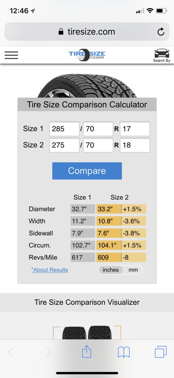

    So finally going to pull the trigger on the OME kit.
    Few final questions.
    1- I'm guessing uca is recommended on this since it has the 888 coil?
    2-can I add two additional 1/4s spacers to the front, and be ok ride height wise without added weight?
    3- should I go ahead and get the ECGS now? Also how long does this add labor wise while doing the lift if having it installed?
    4-want to run 275/70r18s on this setup. Should that be good to go without trimming?

    Can someone help me with these last few questions before I order the full OME setup.

    285/70/17 pretty much require trimming and a CMC or you will get rubbing, unless you never leave pavement and don’t hit any bumps. 275/70/18 is a larger diameter tire, but is slightly narrower.
    I am pretty sure your going to have to do some trimming and probably a CMC if you don’t want rubbing. I did run 275/70/17s KO2s and had some minor rubbing when off road. I switched to 265/70/17s and experienced no rub. I didn’t want to do a CMC. I use Rokblokz flaps that pretty much hug the truck and didn’t have to trim them.
