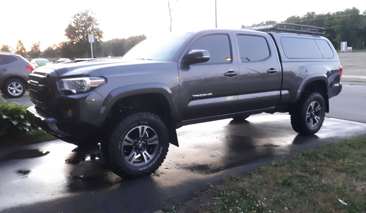

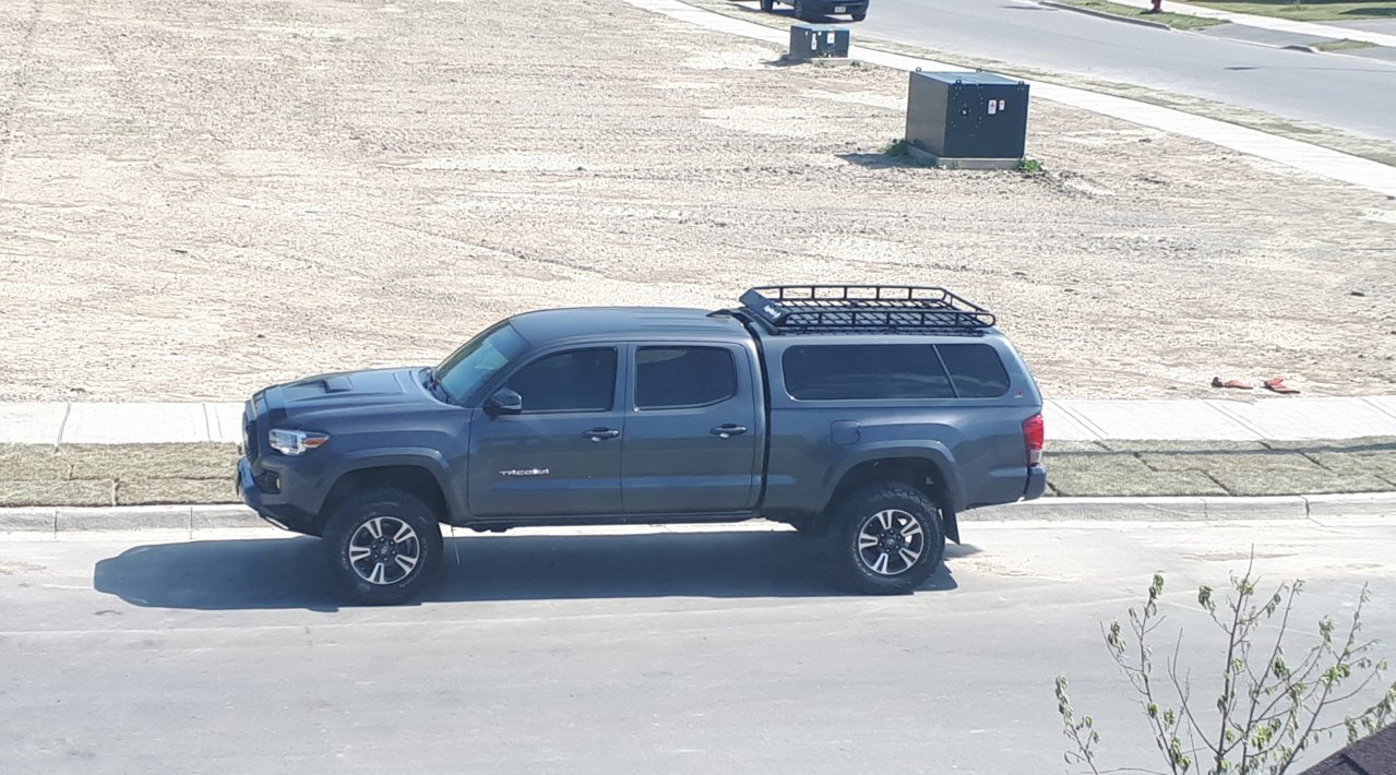

    20180711_213401.jpg 20180711_111433.jpg i went 887/bilstein spc uca and
    HD dakars/nitrocharger
    275/70/17
    Carrier bearing drop
    I added a 1/2" top plate spacer on drivers side and 1/4" on passanger side.
    My cv angles were bad and boots touched.
    Added a 1" toytec diff drop.
    After that and everything settled the boots dont touch anymore.
    Felt the rumble strip vibes after so i installed the ecgs bushing. All vibes gone rides like a dream now
    Got 3" front and back after settle with a little under an inch rake
    Heres my measurements

    Looks fantastic! Were you told you needed the UCAs or just something you thought would be better? How's the ride compared to stock with all that heavy duty suspension gear? Do you plan on adding armor and a winch later?

    Thanks. I kept reading its easier to align at 3" with uca so i save a bit and got them. Rides no different from stockbin the rear with heavy duty dakars. The front rides better, no more dipping or cornerng leans. No plans for armour, just had a baby so its been put on hiatus
