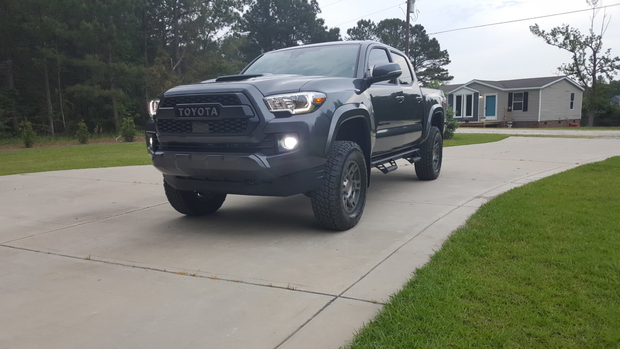

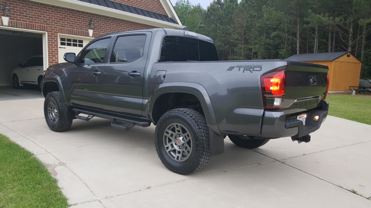

    OK its done, its sits exactly level now after the lift from ground to center of wheel well. Wish I had some rake but its ok for now, may put in 1" blocks in rear later but I have no issues with ride or noise now.
